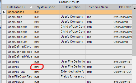

You will need to add the table USERFILE or USERFILELIST to have that column available.
  1. New Table
  2. Schema Table Button
  3. Userf > Search >
  4. Erp.UserFile
  5. Save > Refresh
  6. Unexclude DcdUserId from table report field exclusions list
  7. Save & now you can create the relationship.
Yeah, as @CSmith noted… make sure you try the ERP UserFile… not the ICE UserFile (which shows up first in the list when adding a new table).

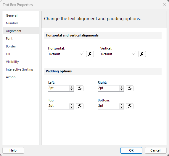

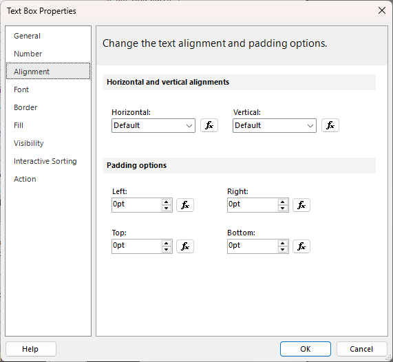

One thing to look at in terms of having things lined up (besides the font), assuming your text box is lined up with the other items which SSRS does help with, is the padding on the text box. IIRC the default is like 2pts on all sides which will adjust where it is sitting, if the other fields around it are not set to the same thing it will be off.
This is on of their fields where the padding is set to 0:
For me at least, when I add a text box into SSRS it defaults those to 2 instead. I suspect that will be enough to make it not line up properly.
As for the font question, again, IIRC just should just need to install the specific missing font on your local machine, I believe that Report Builder shows you the fonts you have installed on your local machine in that drop down, then when the report is rendered the font must also exist on the report server as well.
Thanks Leonard, that has fixed the mis-alignment (I should have noticed that!).
