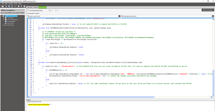

Thanks to all who help me work through this. For anyone else interested, below is the final code that compiled and worked for both DMR Processing and DMR Tracker.
// Custom code for DMRProcessingForm
// Created: 11/20/2018 6:00:41 PM
using System;
using System.ComponentModel;
using System.Data;
using System.Diagnostics;
using System.Windows.Forms;
using Ice.Lib;
using Erp.BO;
using Ice.BO;
using Erp.Proxy.BO;
using Erp.UI;
using Ice.Adapters;
using Erp.Adapters;
using Ice.Lib.Customization;
using Ice.Lib.ExtendedProps;
using Ice.UI.FormFunctions;
using Ice.Lib.Framework;
using Ice.Lib.Searches;
using Infragistics.Win.UltraWinToolbars;
public class Script
private EpiDataView edvDMRHead;
private ButtonTool _btlChgLog;
this.edvDMRHead = ((EpiDataView)(this.oTrans.EpiDataViews["DMRHead"]));
this.edvDMRHead.EpiViewNotification += new EpiViewNotification(this.edvDMRHead_EpiViewNotification);
this.baseToolbarsManager.ToolClick += new Infragistics.Win.UltraWinToolbars.ToolClickEventHandler(this.baseToolbarsManager_ToolClick);
AddChgLogButton();
this.edvDMRHead.EpiViewNotification -= new EpiViewNotification(this.edvDMRHead_EpiViewNotification);
this.edvDMRHead = null;
this.baseToolbarsManager.ToolClick -= new Infragistics.Win.UltraWinToolbars.ToolClickEventHandler(this.baseToolbarsManager_ToolClick);
this._btlChgLog.Dispose();
this._btlChgLog = null;
// Begin Custom Code Disposal
// End Custom Code Disposal
private void AddChgLogButton()
if (!baseToolbarsManager.Tools.Exists("ChangeLogTool")) // Here we check to see if the tool exists yet - "ChangeLogTool" is the standard name Epicor gives it
_btlChgLog = new ButtonTool("ChangeLogTool"); // Create the new tool and put it in our variable
_btlChgLog.SharedProps.Caption = "Change Log...";
_btlChgLog.SharedProps.Category = "Actions";
DMRProcessingForm.setToolImage(_btlChgLog, "ChangeLog"); // This will add the book change log image to the button - you can find the list of names for icons by using the Epicor Resource Editor and opening the MfgBaseImages.resources file from the Client/res execution directory
baseToolbarsManager.Tools.Add(_btlChgLog); // This will add our new button to the toolbar
else
_btlChgLog = (ButtonTool)baseToolbarsManager.Tools["ChangeLogTool"];
_btlChgLog.SharedProps.Visible = true; // In all cases we want to ensure the button is visible
private void DMRProcessingForm_Load(object sender, EventArgs args)
AddChgLogButton();
private void edvDMRHead_EpiViewNotification(EpiDataView view, EpiNotifyArgs args)
// view.dataView[args.Row]["FieldName"]
// args.Row, args.Column, args.Sender, args.NotifyType
// NotifyType.Initialize, NotifyType.AddRow, NotifyType.DeleteRow, NotifyType.InitLastView, NotifyType.InitAndResetTreeNodes
if ((args.NotifyType == EpiTransaction.NotifyType.Initialize))
if ((args.Row > -1))
_btlChgLog.SharedProps.Enabled = true;
else
_btlChgLog.SharedProps.Enabled = false;
private void baseToolbarsManager_ToolClick(object sender, Infragistics.Win.UltraWinToolbars.ToolClickEventArgs args)
if (args.Tool.Key == "ChangeLogTool") // This method will fire for all tools clicked so we put this "if" here to capture the button we want and perform an action
if (edvDMRHead.Row > -1)
Ice.UI.App.ChgLogEntry.ChgLogArgs lfo = new Ice.UI.App.ChgLogEntry.ChgLogArgs("Erp","DMRHead", Guid.Parse(edvDMRHead.dataView[edvDMRHead.Row]["SysRowID"].ToString()), true); // Let's evaluate this outside the code view... continue reading...
ProcessCaller.LaunchForm(oTrans, "Ice.UI.ChgLogEntry", lfo); // Launch the Change Log screen and behold the awesome
else
args.Tool.SharedProps.Enabled = false; // If, for some (unlikely) reason, we get here in the tool click and there is no active record, just disable the button

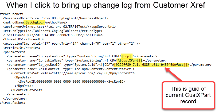

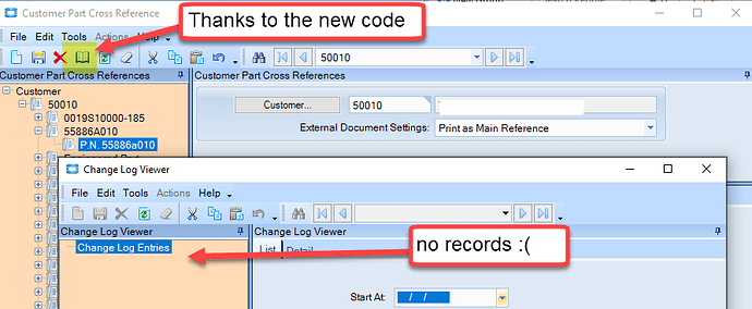

Good Afternoon,
I got this working for the most part via Michael’s and Theodore’s code above (thank you!), but now I’m stuck. I want to view change log on the customer part cross reference program. I have a data directive setup and working on the CustXPrt table to log changes and it works. However, when the new change log toolbar icon is clicked in the customer part cross reference program, it doesn’t bring up the changed records. The one thing a little different with this change log on the CustXPrt is that it has a combination key getting stored in Key1 of the change log table, instead of just the sales order number (i.e., cust id ~ part no ~ cust part no ~ custxprt guid).
Could this be making a difference?
I don’t understand how this code works to bring up the right change log record(s) when it seems to be using the calling record guid to get it:
public ChgLogArgs(string systemCode, string tableName, Guid rowIdent, bool showAsModal);
In the trace I have this that looks alot like the trace looks in sales order entry when I get the change log to come up with records. Any suggestions?
Sales order entry change log comes up ok, here’s similar trace:
Thanks!
Nancy
