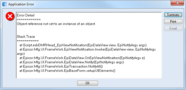

You need to call AddChgLogButton in InitializeCustomCode and remove from the form load event handler
Do I need to insert AddChgLogButton in DestroyCustomCode as well?
Actually, I put the AddChgLogButton in InitializeCustomCode and left it in the form load event handler and it worked.

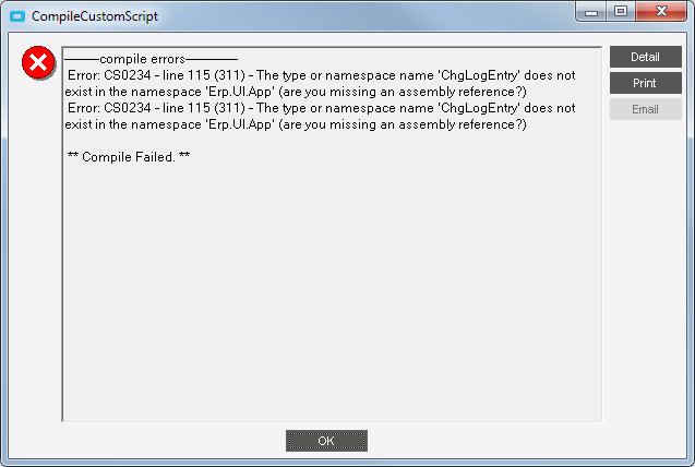

When I am converting to E10, I get the following errors:
What am I missing ?
Michael
Remove it from form load as it does no good a will cause unnecessary memory usage.
It’s located in the Ice.UI.App namespace
Ice.UI.App.ChgLogEntry
In Epicor 9, if I remove it from the form load, the change log button does not appear.
In Epicor 10, I changed all of the Erp.UI.App to Ice.UI.App and I get the following error when tring to compile:

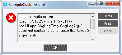

Here is the latest code giving me the constructor error:

ChgLogArgs now expects 4 arguments
public ChgLogArgs(string systemCode, string tableName, Guid rowIdent, bool showAsModal);
Theodore -
Thank you for being patient with me. Like I said I am brand new to C#. If you could help out just a bit more it would be great.
Obviously, I am having a problem with the following line of code:
Ice.UI.App.ChgLogEntry.ChgLogArgs lfo  = new Ice.UI.App.ChgLogEntry.ChgLogArgs("DMRHead", edvDMRHead.dataView[edvDMRHead.Row]["RowIdent"].ToString(), true);
I know you said I need a fourth argument but I do not even know where to begin looking for what that should be.
Any help is greatly appreciated.
The four required arguments are in my last post, you are missing systemCode.
Change
to
Ice.UI.App.ChgLogEntry.ChgLogArgs lfo  = new Ice.UI.App.ChgLogEntry.ChgLogArgs("Erp", "DMRHead", edvDMRHead.dataView[edvDMRHead.Row]["RowIdent"].ToString(), true);
OK … changed that. Now I am getting the following compile error
Error: CS1502 - line 115 (311) - The best overloaded method match for ‘Ice.UI.App.ChgLogEntry.ChgLogArgs.ChgLogArgs(string, string, System.Guid, bool)’ has some invalid arguments
Error: CS1503 - line 115 (311) - Argument 3: cannot convert from ‘string’ to ‘System.Guid’
My bad forgot to change that, should be this.
Ice.UI.App.ChgLogEntry.ChgLogArgs lfo  = new Ice.UI.App.ChgLogEntry.ChgLogArgs("Erp", "DMRHead", Guid.Parse(edvDMRHead.dataView[edvDMRHead.Row]["RowIdent"].ToString()), true);

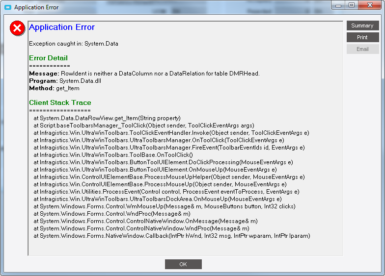

Almost there. That got it to compile. I have a change logs data directive setup and when I try to view it from the DMR Processing form, I get the following:
Theodore -
I got it. Changed “RowIdent” to “SysRowID” and it works.
Thank you for all of your help today.

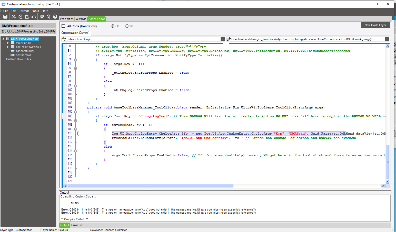

Hi @MLW8595,
i am trying to implement your code in my test environment, did you add custom assembly reference to your form?
For Epicor 10 add a reference to
Ice.UI.ChgLogEntry
thanks for your reply mate, i have done that already and still asking for missing assembly reference
also tried without the [App], no luck
Try adding a reference to this one also.
Ice.Adapters.ChgLog
