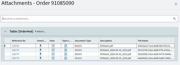

Default:

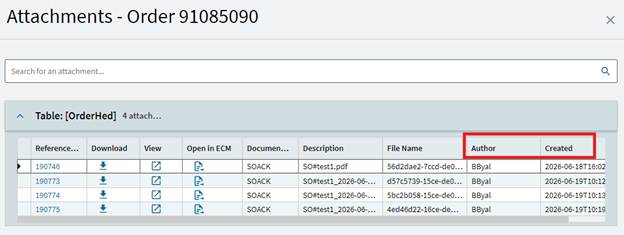

Modified:

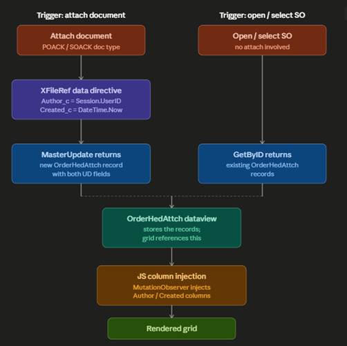

Project Flow

Event
Trigger Type: Event
Hook: Before
Target: Form_OnLoad
Action: Row-Update
Binding: TransView.Watcher (field can be named anything)
Expression:
  • Not a complete copy-pasta! Will have to update it with your respective fields being added to the attachment grid

          t, '| detectors:', all.size); }, 50);
    }, 50);
  function ensure() {
    const attachOpen = [...document.querySelectorAll('.k-grid-header')]
      .some(h => h.textContent.includes('Reference No'));
    if (!attachOpen) return 'idle';
    const grids = findGrids();
    if (!grids.length) return 'no-grid';
    let appliedAny = false, pendingReady = false;
    for (const g of grids) {
      const cols = g.columns.toArray();
      const hasField = cols.some(c => c.field === 'Author_c');
      const painted = !headerLacksAuthor(g);
      if (hasField && painted) continue;
      if (hasField && !painted) { fire(narrowDetectors(g)); assertAndHeal(g); continue; }
      if (!gridReady(g, cols)) { pendingReady = true; continue; }
      const extra = makeCols(g, cols);
      if (!extra.length) { pendingReady = true; continue; }
      try { injectAndResync(g, cols, extra); }
      catch (e) { console.warn('[attachCols] inject threw - will retry', e?.message || e); pendingReady = true; continue; }
      fire(narrowDetectors(g), true); assertAndHeal(g); appliedAny = true;
    if (appliedAny) return 'applied';
    if (pendingReady) return 'no-grid';
    return 'noop';
  let timer = null, obs = null, retryTimer = null, retriesLeft = 0;
  const RETRY_MAX = 8, RETRY_MS = 100;
   const attempt = () => { try { const r = ensure();
    if (r !== 'idle') console.log('[attachCols] attempt ->', r);
    if (r === 'no-grid' && retriesLeft > 0) { retriesLeft--; clearTimeout(retryTimer); retryTimer = setTimeout(attempt, RETRY_MS); }
    else { retriesLeft = 0; clearTimeout(retryTimer); }
  } catch (e) { console.warn('[attachCols] ensure error', e); } };
  const debounced = () => { clearTimeout(timer); retriesLeft = RETRY_MAX; timer = setTimeout(attempt, 120); };
  function arm() {
    if (window[NS]._armed) { attempt(); return; }
    window[NS]._armed = true;
    attempt();
    obs = new MutationObserver(debounced);
    obs.observe(document.documentElement, { childList: true, subtree: true });
    log('armed - watching for attachment grid');
  function disarm() { try { obs?.disconnect(); } catch {} obs = null; clearTimeout(timer);
    window[NS]._armed = false; log('disarmed'); }
  window[NS] = { ensure, arm, disarm, findGrids, _armed: false };
  window[NS].arm();
Working Example:
