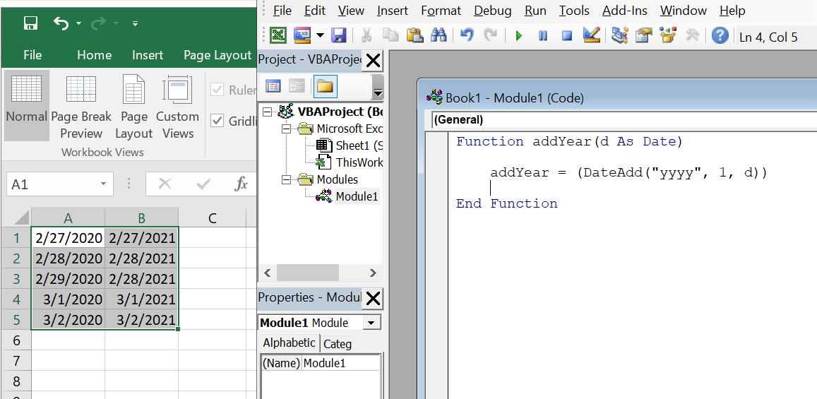

C. Add 1 to the year. 1/1/2020 → 1/1/2021, etc… But what to do if the input date is 2/29/2020? There is no 2/29/2021.

I would guess that is the expiration limit after that would be the correct expiration for this leap year. I also follow your suggestions and I like the simple +1 to the year, and for the leap year 2/29 if that’s expiration date I would think 2/28 to be within cutoff date and 3/1 to be an expiration or past due.
