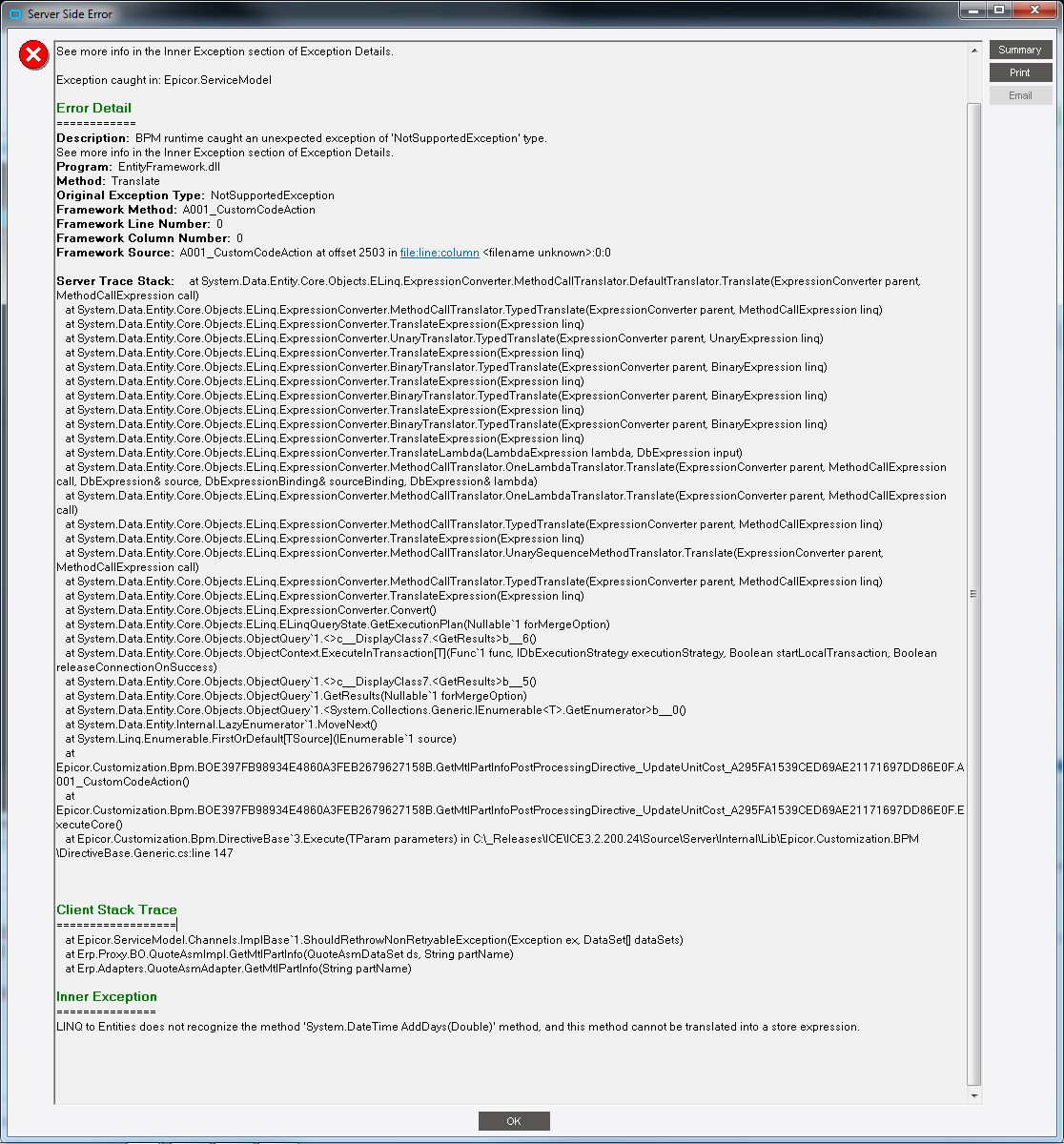

I am trying convert a Post-Processing BPM on QuoteAsm.ChangeOpMtlReqQty method. Whena new material is added to a quoteline method, I want to look at a future supplier price list for the cost. Price lists would be entered for 1, 2, or 3 months out. I am trying to use DateTime.Today.AddDays(28) in the C# code for searching the Supplier Part table but keep getting an exception.
What am I doing wrong. Cose is below and Exception follows.
