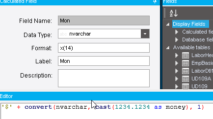

I used this in a test:
Instead of 1234.1234, you’d reference your number field
