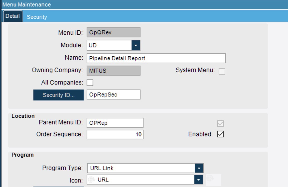

You might be able to use the URL Link option:
Thanks. I tried that but it just opened my web browser.
You shoudl be able to specify a URL to the file itself on sharepoint or whereever and the browser should open it.
If you want to open local files, chose “External Process”.
Put your filename in the “Program” Text Box: “C:\Users\username\Desktop\filename.csv”
Of course this only works in classic.
