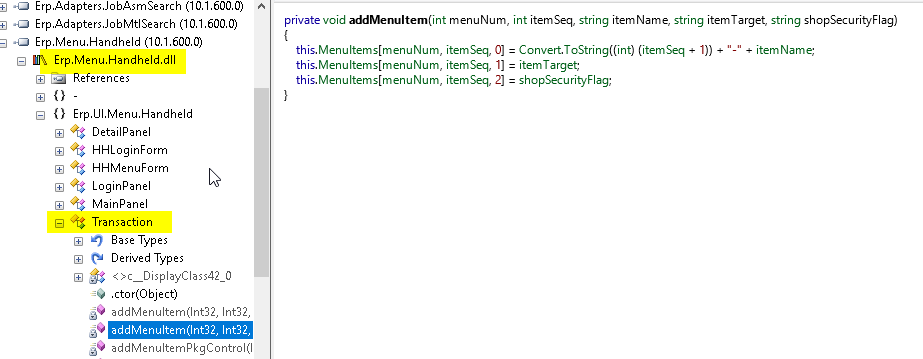

Do you know where I can find the signature for the addMenuItem method?

10.2 and multi-tenant hosted. I am not familiar that particular flavor. Get you a decompiler like ILSpy or Reflector and open up that erp.menu.handheld.dll (assuming you have a physical client - like I said, I have no exposure to hosted) and you should find it.
Yes, you’re right. There’s no longer an addMenuItem method in Erp.UI.Menu.Handheld.Transaction. Looks like you have to add items to the table directly.
I was able to decompile the dll and found that there’s no longer an addMenuItem method there. That explains the null return from GetMethod. Looks like you have to add the items directly to a table.
