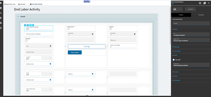

Thanks to the fantastic contributors on this thread, I have a working Kinetic layer on End Activity Entry:
https://www.epiusers.help/t/issue-with-creating-a-drop-down-menu-in-kinetic-data-collection-using-application-studio/

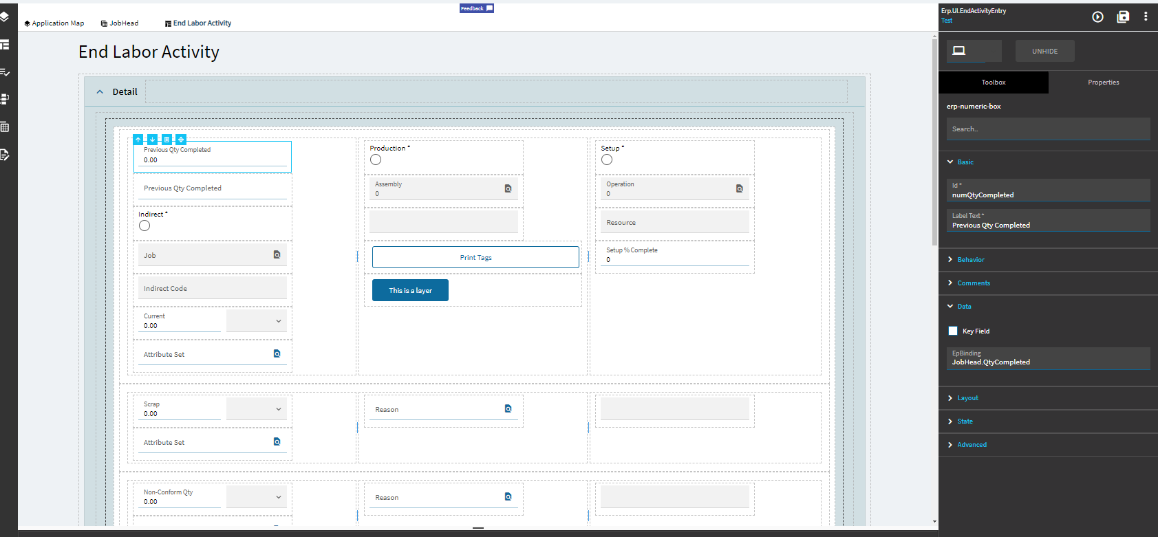

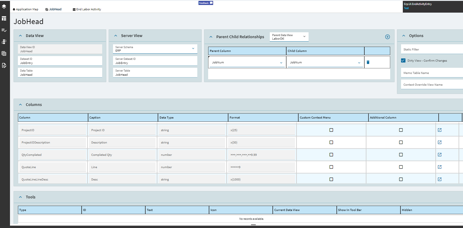

Now I just want to add JobHead.QtyCompleted but I am missing something. I probably bungled the dataview.
I’ve tried the dataview with and without a parent/child association, and I’ve tried it on both JobAsmbl and LaborDtl. I’ve also tried both a text box and a number box control.
You guys see anything obvious?

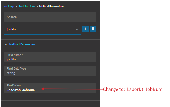

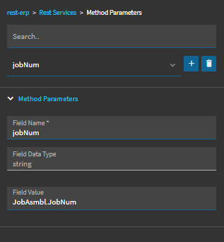

My best guess is you need to adjust your Method Parameter.
My thinking out loud:
You’re making a rest call to pull in the JobHead information based on a JobNum.
The “Field Value” in your method parameter is the value you’re sending in order for the call to make a match and “GetByID”.
Initially, I was thinking JobAsmbl wasn’t an available view… it IS listed on EndActivity:
But what’s weird is, if I look in debugger when running End Labor Activity, I DON’T see JobAsmbl… can’t explain why at the moment.
So, I’m wondering if that’s why you’re getting your error. Its looking for JobAsmbl.JobNum, but it doesn’t exist (even though there’s a dataview on End Activity in App Studio, but, again, not sure why at this point).
However, LaborDtl also includes the JobNum field. So, perhaps, in this case, I would try LaborDtl.JobNum and see if that works.
I tried this change on the OnCreate event and got the same error as before.

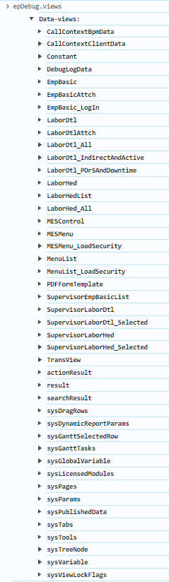

Another handy one is: epDebug.views
If you type that in your prompt, (again, assuming it works in Brave) it should generate the list of dataviews (like the image in my earlier post). You can open those up and see what data is populated in a particular view at that point in time.

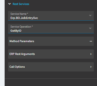

If you can start seeing your event firing in Debugger, you should be able to click on the “Network” tab. This will give you a list of activity. You should see your “GetByID” call. Click on that and you can look at the Payload (the Method Parameters you’re sending), hopefully you’ll see jobNum and the value we’re assigning to is from LaborDtl.JobNum.
Then you can click on “Response”… this is what the server is sending back.
Again, not sure what you’ll see since you’re getting an error. But perhaps some breadcrumbs we can use.

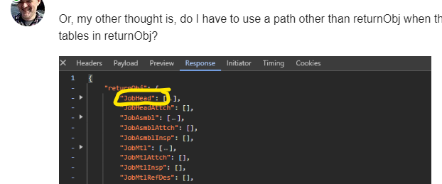

Or, my other thought is, do I have to use a path other than returnObj when there are nested tables in returnObj?
Sorry to double post but I should clarify that I rebuilt this layer a couple of times after the OP and reading the suggested thread, and during one of the subsequent builds I renamed the dataview from just JobHead to JobHeadAdd, which is why it’s different in the pic in the OP.

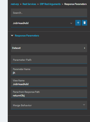

Try this… I’m not positive, but hopeful.
If I look at my example:
Notice my Parameter Name is ReqHead
That is the name of the “Parameter” I’m looking for in my Response Parameter:

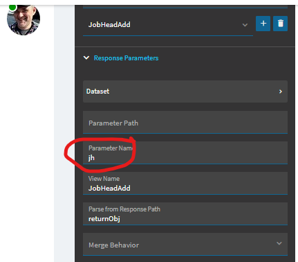

In your case, your “Response” shows your target response parameter as “JobHead”…
but in your snip above, your parameter is just “jh”:
Change that to JobHead and see what happens. See if you’ll get a response.
Today I learned “Response Parameters”
