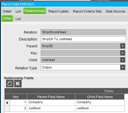

I added the JobHead to the Packslip (Data Definition)
I added the information below on the expression:

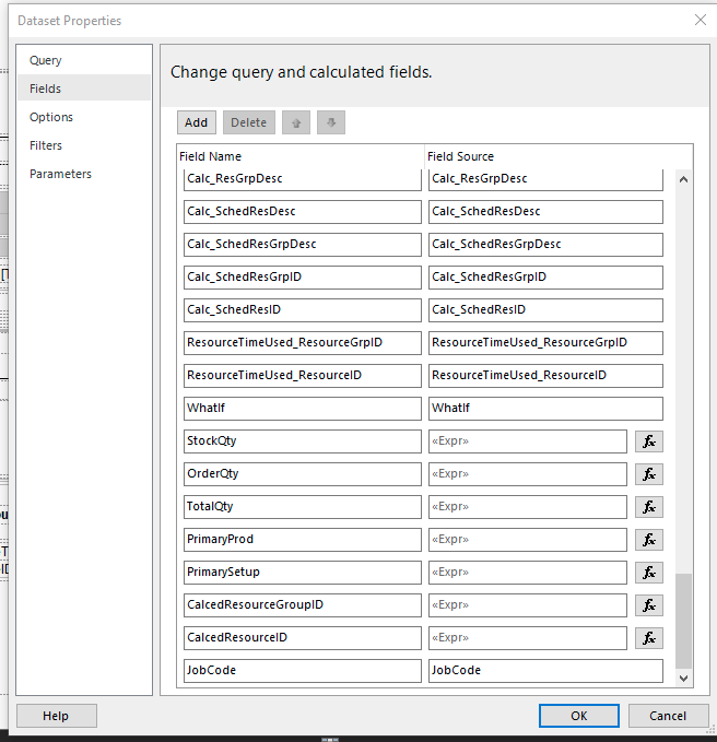

Once you add the table and fields to the expression you also have to add the fields. I use Report Builder for SSRS reports. I right click my dataset and in the data set propertiesAfter I add the table and fields to the expression (I’m using Job Traveler as my example) I click Fields, click Add, scroll to the bottom of the list and add my fields.
The fields should then show up for the report and have data for them. HTH.
