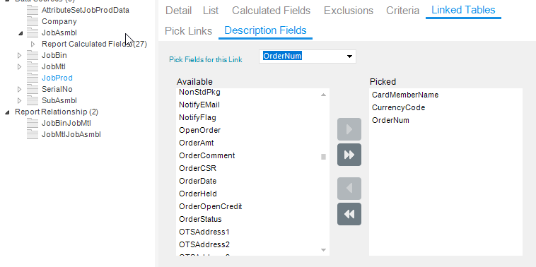

I need the JobProd table as I need the OrderNum for the Job Pick List RDD. I added the JobProd table then Linked Tables, found OrderNum, click the Drop Down for OrderNum and then selected OrderNum again. I went into SSRS and added the table

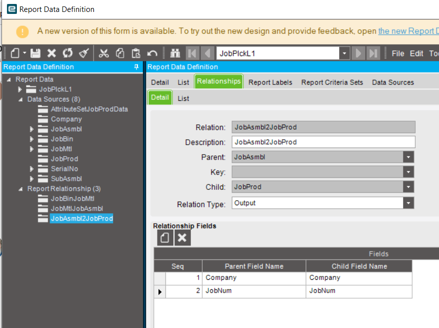

That did not work, still same error. I included a screenshot of the RDD as well

Maybe, instead of adding to Linked Tables, create a Report Relationship to bring in JobProd for Output.
Looking at JobProd in BAQ, it appears that PartNum is now JobHed.PartNum. So you’d likely have to keep this in mind in the design.
Unfortunately, we have not added this data so I have not run into the gotchas on this one before.
I would guess you would want to add a relationship to make this work.
Also, Joining with JobProd could create multiple records. It would be much safer to use a Dataset in SSRS to get the Order Information you are looking for.

Still getting NO RECORDS SELECTED. I added the JobHead table and deleted the JobProd table as well.
For the relationship, wouldn’t I need to add OrderNum for the 3rd sequence?
Mr. Gregory: you will not be able to add the order number as the third - because the order number does not exist in JobAsmbl Table.
