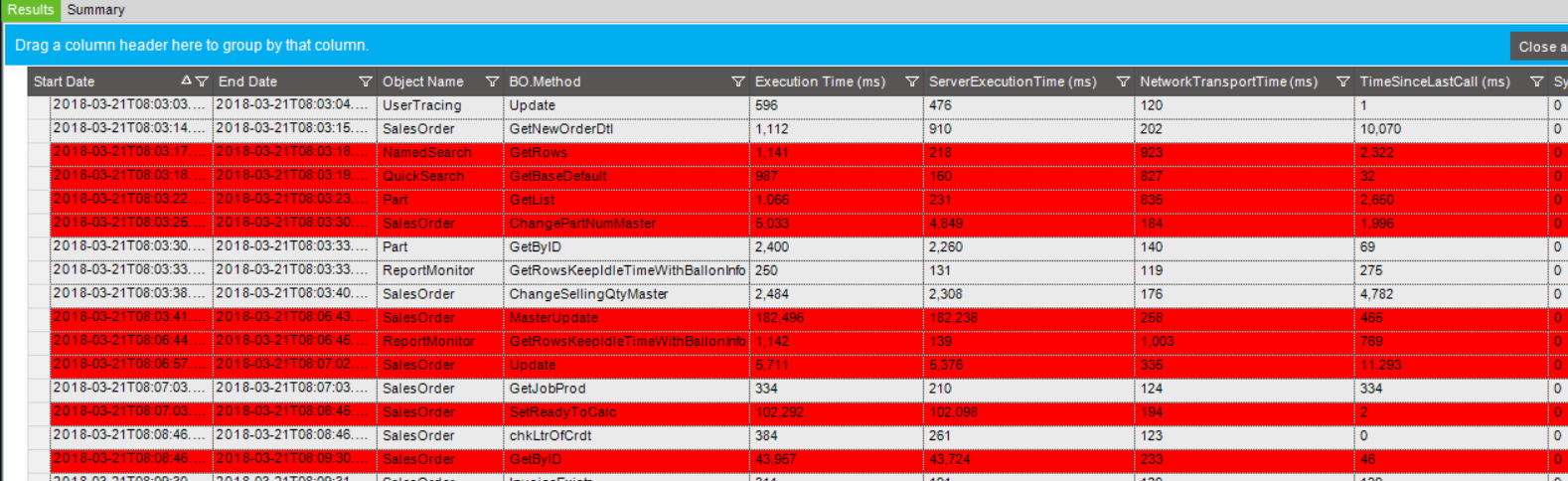

Running PDT against a trace file I get the following

I think one thing I would try running is the Epicor Administration Console - Performance and Diagnostic Tool - Config Check on your Epicor Server. We had an issue with RuleID SQL003 - SQL Server Available Space and the MDF file had less than 25% free space. I think we had hit such little Free Space in our MDF file that it suddenly caused a slowdown in various processes for all users due to the constant auto-growth events that needed to be performed.
EpiCare AnswerBook # 17902MPS
For this rule, we are looking for at least 25+% free for a clear PASS and between 10% to 24.9% free for a WARNING in your transactional database for ROWS data. This rule is about “right sizing” your database to prevent auto-growth events which can cause index fragmentation and delays during transactions during the auto-growth event itself if the SQL server user account doesn’t have the instant initialization permission. This rule only applies against a production / live database and doesn’t need to be completed against the Epicor training database (as an example).
