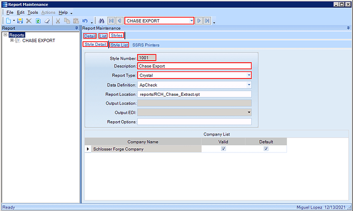

I need some assistance in having my new form show up on the drop down of forms available. I created a new Check form and used Report Style to attached the new form to. But how do I make the new form display on the drop down?

Are you multi company? If yes there are settings for each company
Did you close and reopen the form? The list of report styles is only fetched when the form loads.
Check the Valid (and Default) options on the Report Style > Styles / Style Detail / Companies/Images tab
Hello It appears the setup is ok. See Below:

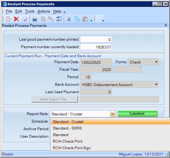

But new form does not does not appear on drop down.

Do those 5 styles (Std - Crystal, Std - SSR, Std, RCH-Check Print, and RCH-Check Print Sign) show in the style maintenance?

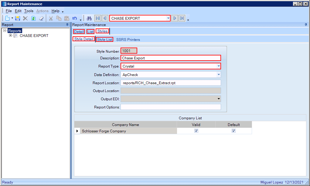

Do all the fields for your style 1001 match those of an exist Crystal Report style (like “Standard - Crystal”)?
