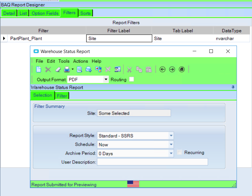

I was able to use the BAQ Report Designer – Report Filters (which does work).

I think you are correct. You cannot use the BAQ parameters as filters. It appears it has to go in the BAQ Report Filters.
