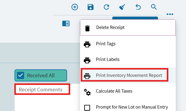

I need to add the RcvHead.ReceiptComment field to the Inventory Movement Report in Receipt Entry.

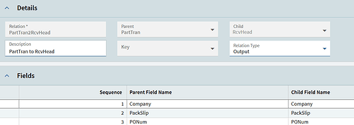

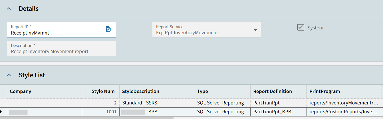

I’ve already copied the standard style to a new report style and changed the RDD.

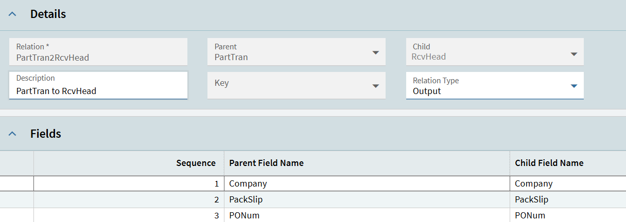

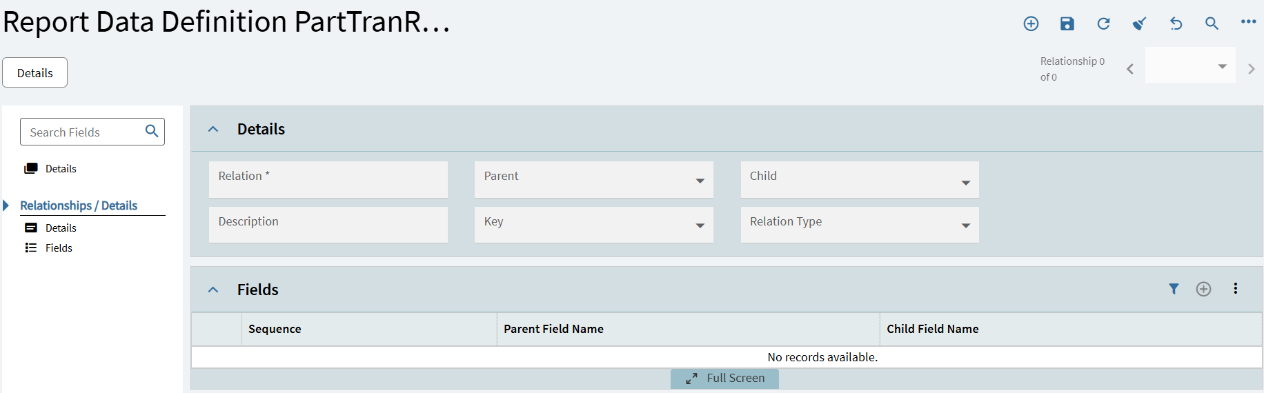

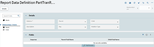

For the RDD, I originally thought I could use the standard PartTranRpt since it already has RcvHead listed as one of the data sources, but there’s no relationship listed.
So I duplicated the report and added a relationship

That report is really tricky. The data set doesn’t make a lot of sense and its mostly black box. You could try printing T1.PONum and T1.PackSlip on the report just to see if the data you expect exists. And/or printing out the entire RcvHead contents in a separate tablix to see what data is being returned there, if any. If RcvHead is already in the system dataset but without a visible relationship, I would not add a relationship to the RDD. It may not be joined the way you think it is, and adding that relationship might actually prevent it from returning the data.

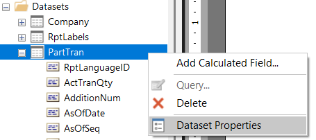

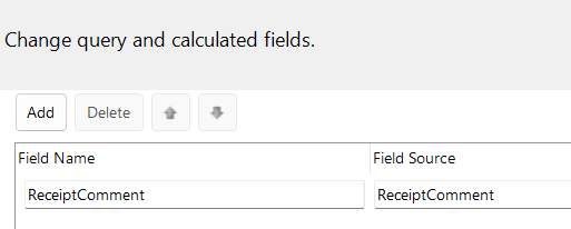

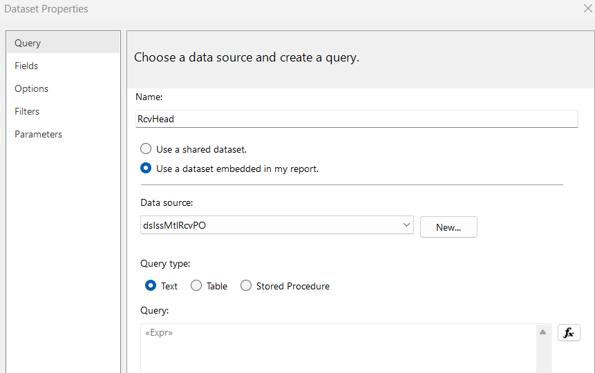

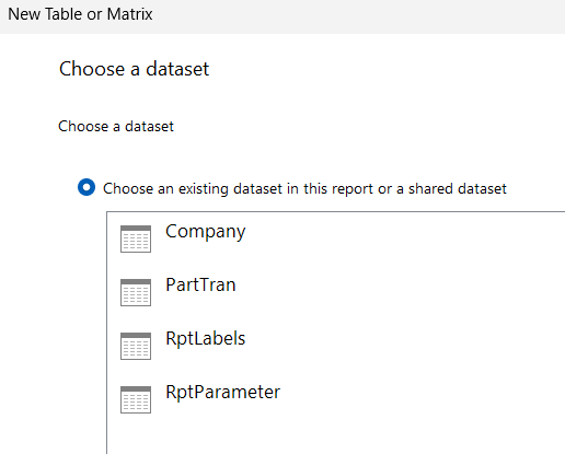

I tried adding a dataset.
Then added the query and the field
Is that what you mean?
Yep

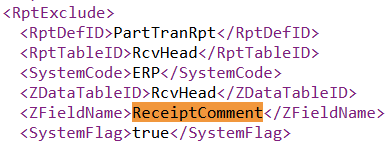

I just looked in the data and the definition, and this is in the standard report.
So no need to edit the rdd, just add the dataset and field like you did.
Yep I went back to the standard RDD.

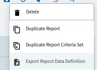

How do you see that?

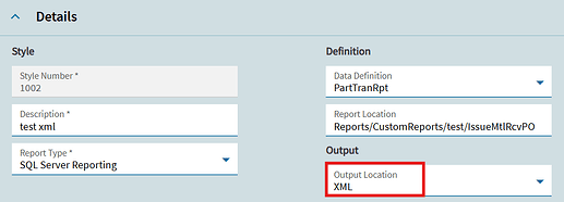

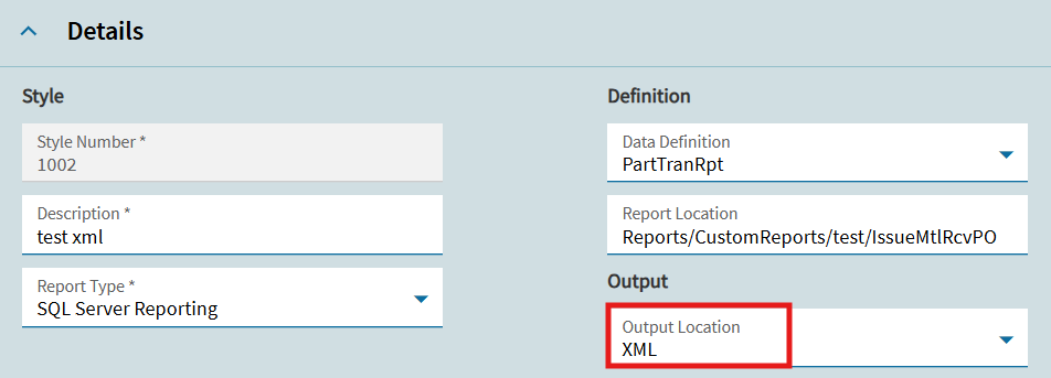

I copied the report style, set it to xml, and generated for design. Downloaded from the system monitor with download crystal data.
Does that work on the browser client? I don’t think I see that option here.
Its in report data definition, change output to xml.

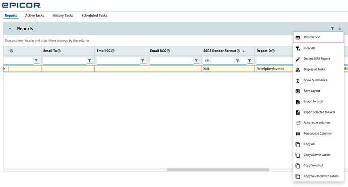

Is it this one?
The output looks different from what Kevin showed.
No, the output.
Gotcha, thanks so much to you both!

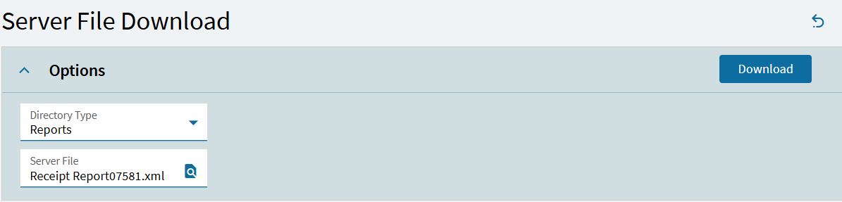

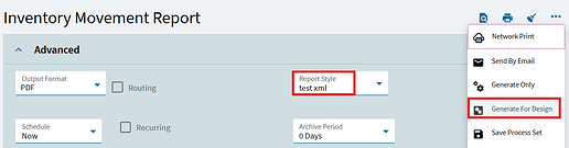

In case someone else on SaaS needs the steps, here’s what I did:

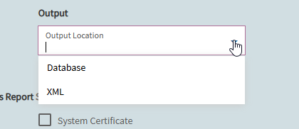

  1. In Report Style, copied the standard report and changed the Output Location from Database to XML

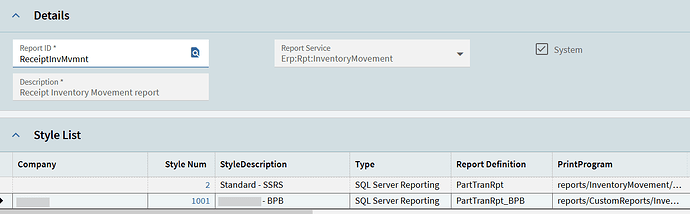

  2. In Receipt Entry > Print Inventory Movement Report, changed the report style, and selected Generate for Design

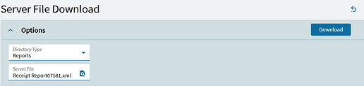

  3. Opened System Monitor and located the File Name column
  4. In Server File Download, changed Directory Type to Reports, located the file and clicked Download
Thanks again for the help, much appreciated
