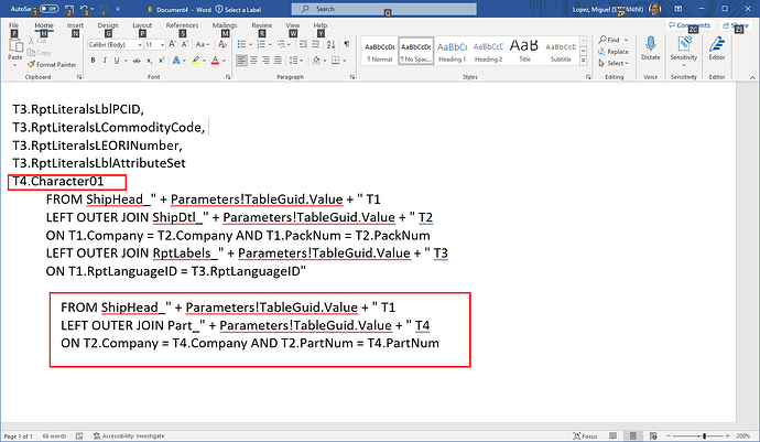

I need some assistance in adding table to expression. I added the Part and the JobHead Table and need to add the expression to populate on my form.
This is what I got from UTube but it doesn’t work for me.
I added only part as shown below in displaying T4:
Thanks in advance.
Miguel
You want it to be
T2.Company = T4.Company AND T2.PartNum = T4.PartNum

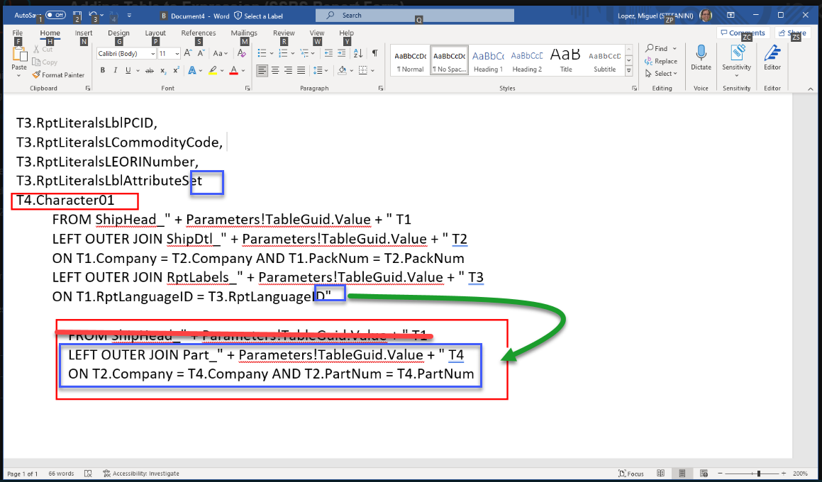

Hello John,
The file errored when attempting to upload.
I added the text in the red boxes, there is probably an error on my part (see below)
Thanks again.

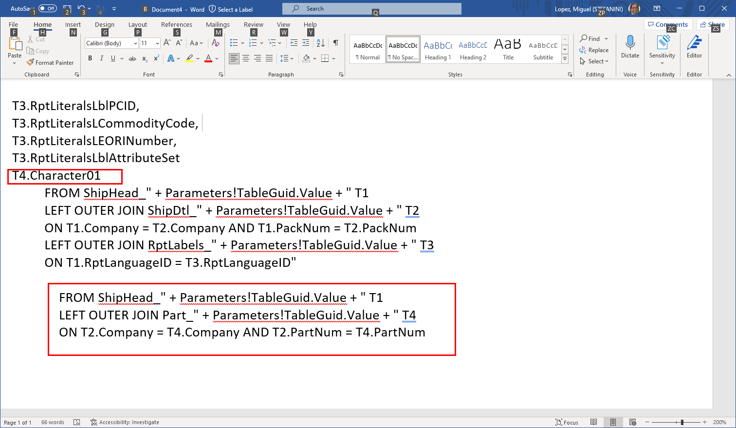

The “ after T3.RptLanguageID need to be moved to the end of the statement, T4.PartNum”
I marked up your drawing to show where I changed things and also wrote it out below (beware of typos!). The first thing is that every field listed must have a comma after it, except for the last field in the list. The " at the end of the original block is the end of the code area, so adding data in requires the " to be moved to the new end. You don’t need another FROM, you are piggy backing off of the first one, so you can just add what I boxed.

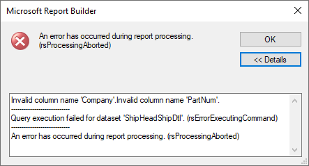

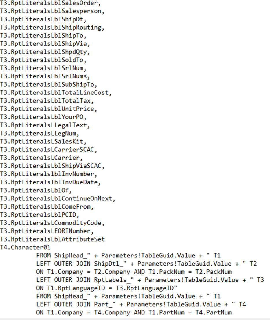

Hello John,
I am getting an error when I add. This is what I am putting in.
(See below)
Thank you.
You have an extra where I circled, delete that and try again.

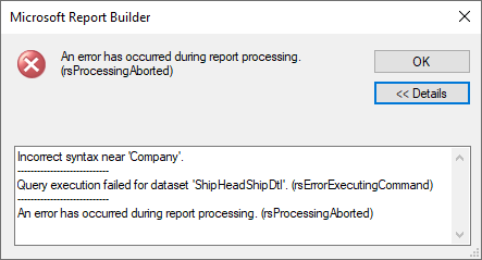

Hello John,
I made the change and now I get a different error. (See below)

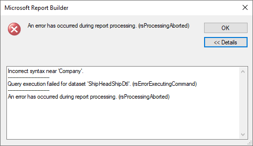

I am still having issues trying to add the Part Table to my query.
This is the error I get when I run the query:

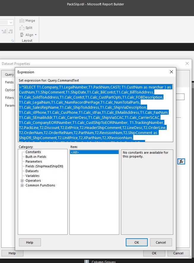

Below is my entire query:

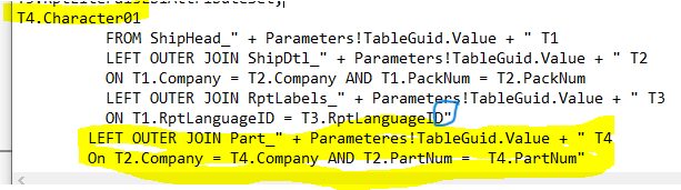

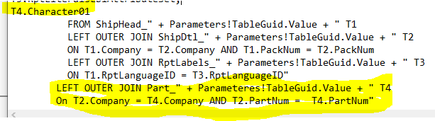

You Missed the .(DOT) it should be T4.Company
Hello Patel,
Thanks for your help. Unfortunately, the error still exists.
Miguel
That also says Parameteres! instead of Parameters!
