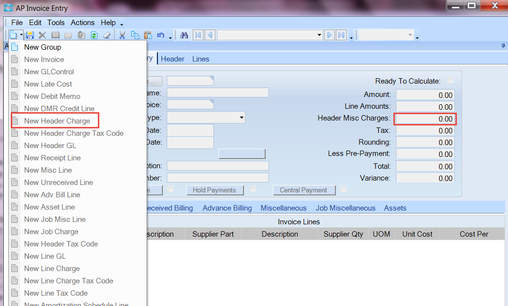

You could add it as Misc header charge but i believe you would need to setup the header charge GL control acct under : Financial Management > Accounts Payable > Setup > “Miscellaneous Charge/Credit”
Create by naming the Misc charge and assign a GL control to it. Next time entering AP invoice, enter the normal invoice amount and instead of New Receipt Line, there is New Header Charge. Select the one you created from the drop-down and enter the tax amount.

After looking at some of our old AP invoice entries, it seems like our tax is entered via Misc Line instead of Misc header charge. So, our AP personal is manually entering the tax amount and GL account same as invoice GL.
The Misc header charges, we use that for expediting fees, freight, etc which has fixed GL accounts already linked to the GL control assigned. In your case, since you want all the tax GL to be same as the invoice, my earlier suggestion may not work.

That being said, in your current circumstance, I would create a misc line charge and set it to 0% and then change it as needed. I still think there will be a PPV because the invoice still won’t match the PO. If that is the case, then the PO will need to be changed to avoid the PPV.
Oh, and the GL Account will go behind the misc charge that was created.
