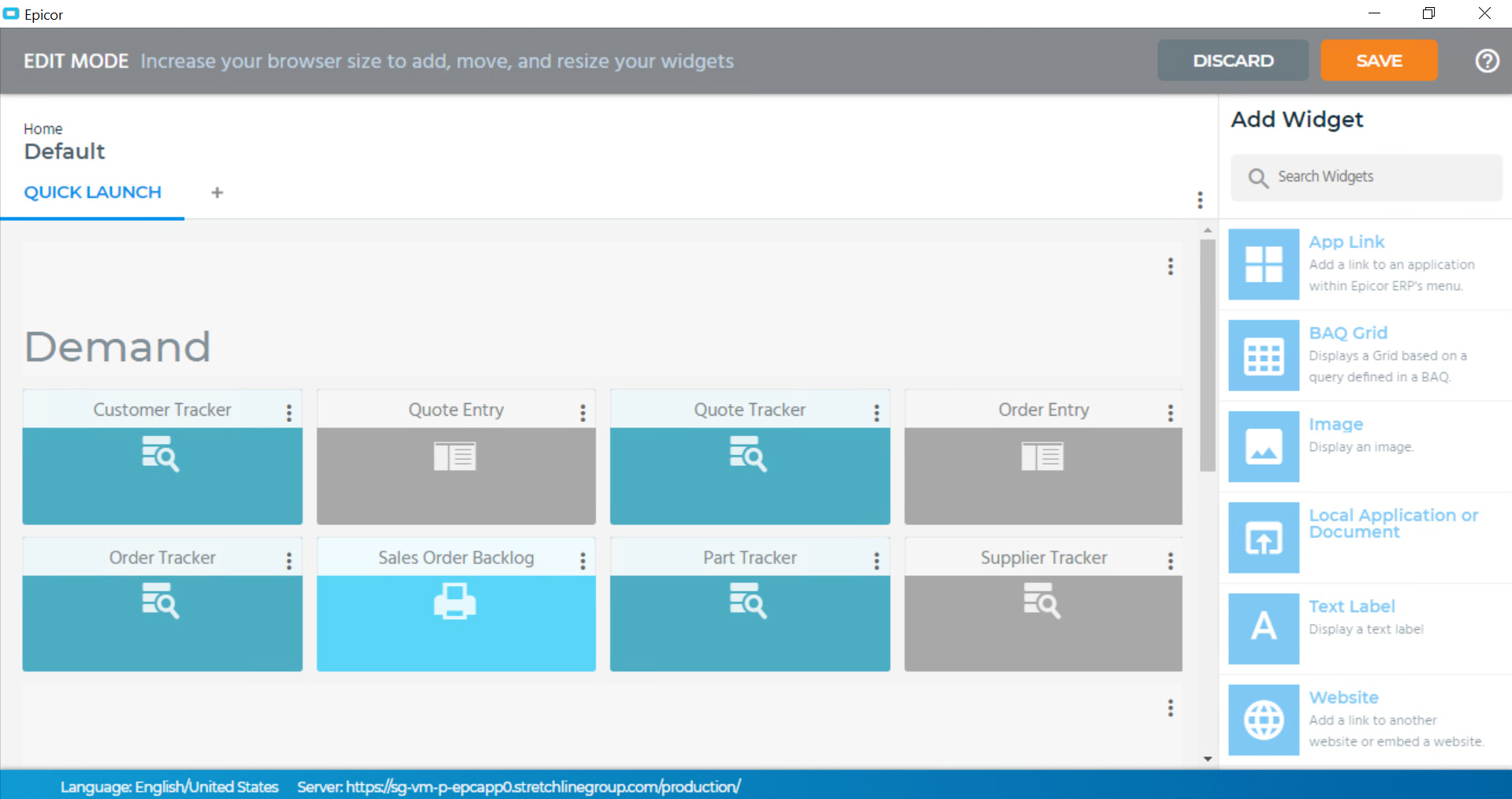

Please check below screen when i try to add widget i get the displayed message and widgets are grayed out.
  1. is it require EDD installed to enable adding widget?
  2. Is below message due to screen resolution or something? I did try by maximizing window but still same.
Version 10.2.300.11
Please advice.
If you have a license for EDD and have EDD installed, it’s most likely a screen resolution issue. We run into from time to time. We have not found a great fix other then messing with the screen resolution in Windows. Rather annoying bug.
Solution is to shrink your browser to 80-90% using Ctrl -
