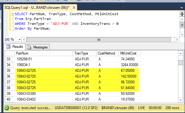

One more question to answer, is does it Recurse through PartTran if you have purchased this PartNum in the past to determine an actual AVG, If it’s from the same Vendor. (I can test this logically)

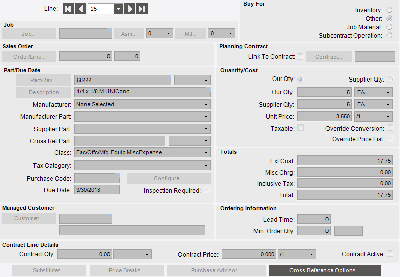

  1. I’d mark post 16 as the solution
  2. I would be incredibly blown away if it did that recursion thing you mentioned. We have many PUR-UKN PO lines that use the same “Part Number” for entirely different things. Like the following:
Using historical costs for something that might not even be the same thing, would be incredibly bad.
I wonder if they recurse with the VendorNum in mind… I doubt it, I doubt they recurse, perhaps they don’t recurse and its a 1 time thing, Per TranNum.
EDIT:
Based on your screenshot, you have proven that it doesnt recurse, aslong as its for the same Vendor, is it? =) otherwise your AVGs would be diff.
Yes. All PO’s for the part in my example were for the same vendor.
