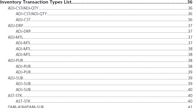

JT - Take a look at the Tech Ref Guide for Inventory Transactions. You can download that from Epicor for your version. The ADJ-CUS type is not listed, though.

Here’s the list of ADJ-??? transactions in the TechRef:
