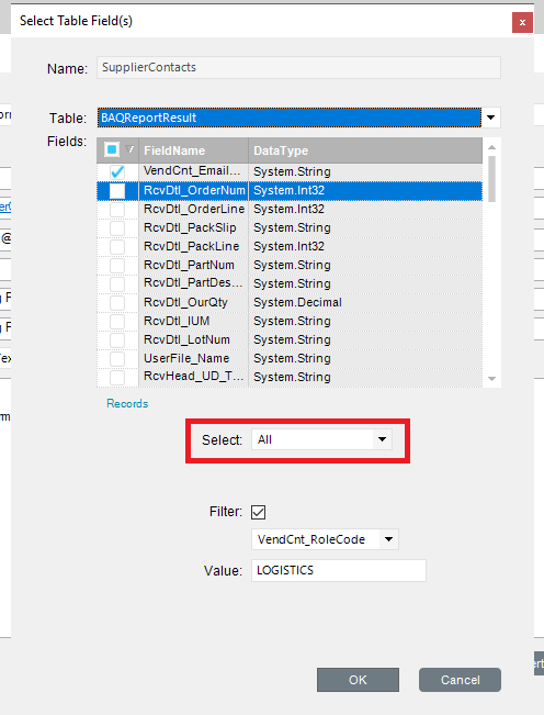

Does anyone familiar with the APR module know what determines if the “Select” dropdown shows up when inserting fields in a Send Email Node? This is within a Breaking/Routing Rule. I have seen it show up before, and found the below image containing it in another thread on this website, but I can’t get it to show up on mine at all. I have tried creating new Send Email nodes, and even creating a fully new breaking/routing rule, but it still doesn’t show up. I highlighted in red in the image to make it easier to see.

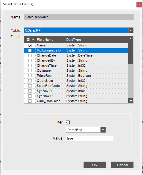

The salespeople look to be stored on a separate table, QSalesRP, which contains both the QuoteNum and the SalesRepCode. That is the table I am trying to query to get this Salesperson Name. I will include an image of my “Select Table Field(s)” below.
Also, I think I’ve discovered how it chooses which SalesRep to grab - it looks to be alphabetical based on the Salesperson’s Name.
Here I am getting the SalesRepName from the QSalesRP table.

I want to choose only the rep marked as the PrimeRep. The filter doesn’t work. It seems like it doesn’t search through the list for one that matches the filter, but instead just takes the first in the list and applies the filter.
So as I have it now, it shows the information if the first in the list happens to have PrimeRep as true. If the first in the list has PrimeRep set to false, it just shows an empty string.
EDIT
To be clear, when I say the filter does not work, I mean it does not work for my purposes. It does what I think it’s intended to, which is hide the information if it doesn’t match the filter. I think if I can get the “Select: All” setting working, the filter might then start working for me (hiding the other, non-PrimeRep records).

Yes, that’s exactly right. I’m pretty sure that is what is happening, which is why I think the “Select All” option would help. It seems like “Select First” is what it’s set to right now.
That “table” named “QSalesRP” was bugging me…
Turns out, that’s not a real DB table, but rather one of the temp tables created by the report process. If you go into the RDD for your report, I bet you see a datasource named “QSalesRP”. And the RDD is actually building that when the report is run.

I took a look at the QSalesRP table through SQL and it does indeed include all the sales reps that the quote displays.
I have found a kind of ugly solution - I couldn’t figure out a way to sort in the RDD, but I was able to add a field to the join between QuoteHed and QSalesRP that matches the Quoted field to the PrimeRep field. Since this form can only be printed when the Quote is marked as Quoted, it will always only return the PrimeRep.

Also, I think I found the answer to my original question. It’s not helpful to me, but I wanted to add it here for anyone who googles this question in the future and finds this post.
It looks like that “select all” box is only available when inserting data into the “To” field.
