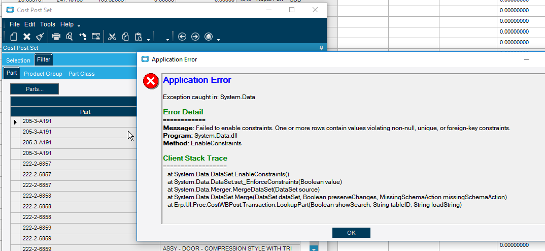

I’m working on setting up an advanced search for the costing workbench for a part number filter. I have a baq, that feeds into a dashboard that has the like field of part number set up in the advanced search setting. The dashboard shows up in the list of advanced searches, however the first time you select a part(s) is give this error, then all of the parts show in triplicate.
The weird thing is, I can delete all of the parts on the list, then search again and it works just fine. Does anyone know why this error would be showing up?
Side note, is there any way to get the dashboard to filter by the current cost set? It’s not a huge deal to select it, but it would be convenient if I didn’t have to pick it every time.
So I get the same error with a quick search as well. Is it something as simple as making sure that some field is in the BAQ or something? is there a way to check for this?
I’ve narrowed down the problem to having more than one costing group with the same parts in them. Since I’m testing in pilot, I’ve been creating new test groups using the same assembly. I went and deleted all of the previous test groups and the error goes away. Now to report the bug to epicor.
