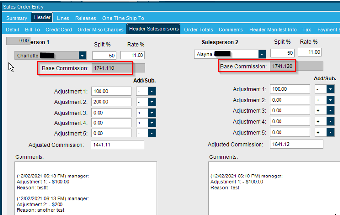

Background:
In Sales Order Entry, I created a commission adjustment calculator to track the correct commission value we pay our reps, in Epicor. I created a Sales Order Update Pre-Processing Method Directive to do the logic of the calculation. This is all done with the widgets, as I have no real experience using C#. For the most part, I am happy with how it all works, there is just one condition that I am having trouble getting the BPM to trigger on. That being when the Base Commission value changes, re-calculate the Adjusted Commission.
