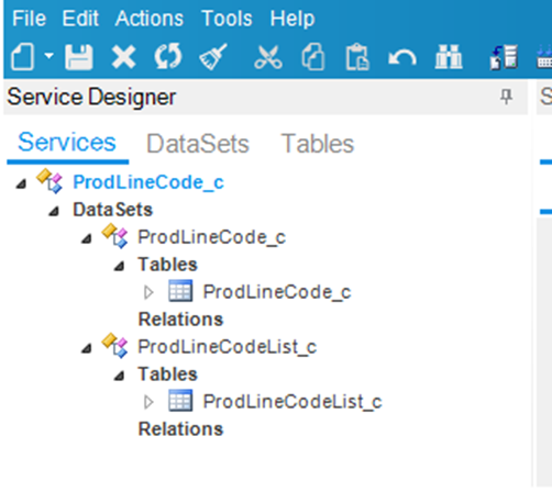

For deploying custom tables that were created using Cloud SDK, I’ve now gotten to this point:
Does anyone have any best practices yet for using Solution Workbench for this?
Here’s what I’ve done so far; it seems to have worked:
I used “Service Designer” to create a service named ProdLineCode_c, as follows.
(The thing with “List” in its name gets set up automatically in Service Designer, it isn’t a real table in the database. This creates just one real table in the database, named ProdLineCode_c.)
To deploy this to a different environment, I used Solution Workbench to create a solution with
  • Two items of type “ZDataTable” - one for each “Table” shown above
  • Two items of type “ZDataSet” - one for each “Data Set” shown above
  • One item of type “ZBODef” - for the “Service” (that is “ProdLineCode_c” shown above in blue letters)
Intalling the solution does seem to work. Is there anything else I should know to improve on this?
Does anyone know of a way to delete this table/service from the destination environment after installing it there, without using Service Designer?

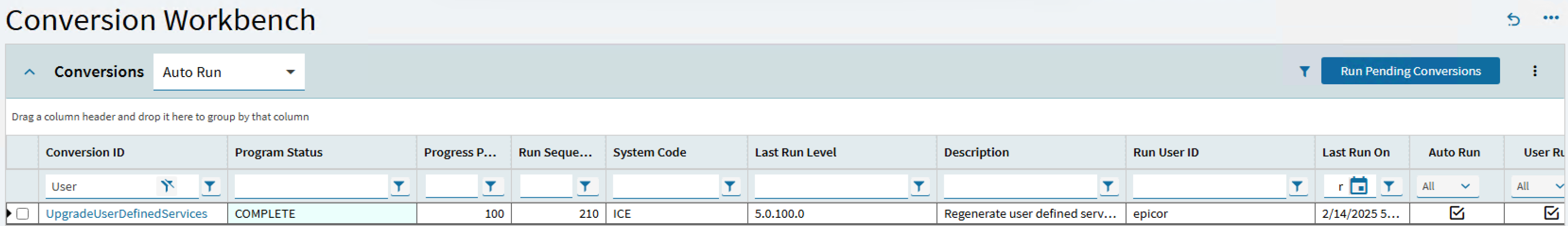

These are the rough steps we follow for deploying SDK solutions to cloud customers.
  1. Export all the components of your new custom service (tables, BO’s, etc)
  2. Import the solution to the cloud env
  3. Run data model regen
  4. Run this specific conversion program:
That last step will generate the required DLLs on the server for you and is the equivalent of running the “Generate Service” in the classic screen.
