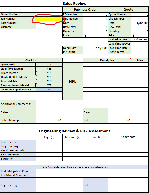

From what I can tell, our process flow is all jumbled. According to our QC manager that worked at a previous company that was in aerospace, the job# is important for starting the CR process. The way our jumbled system currently works is this. Quote → PO comes to Sales → Sales notifies engineering that an internal cross reference part number needs to be created. (at that time they also create the method). Once the PN is done → Sales Creates the SO → Scheduling Creates the Job# and schedules the job → Sales then starts the CR process now that they have the job# to tie to the SO and quote → Engineering finishes any prints → QC signs off that we have met all necessary criteria → Production manager says whether the job needs to be rescheduled if the CR process has taken too long to start the job on time → Traveler is printed and hits the floor. If at any point, there is something missing that is needed from any department, it gets “kicked back” to get that information added before the next person signs off on it. Some of these only take a day to get through if they’ve been through CR before and others which are brand new parts have taken a week, or at times get hung up somewhere for at times 2-3 weeks before they move on to the next person. Before CR, new parts took at most 3-4 days before the traveler could hit the floor waiting on material to start the job. This is just new to us, so we may have to change our process flow, but the QC manager says the CR review must be done this exact way. I’ve been looking at Cre8tive’s solution and will be bringing it up but only after we decide on some other things that are in the works. Hopefully this clears up the muddy situation we are in and help with any suggestions.

The job# may have been all he had before in order to tie things together. Right now, we use a separate spreadsheet that is filled out in each area with Sales and Engineering carrying most of the workload. I created a BAQ that is used as a dashboard that has most of all of the information that Sales needs so that all they need to do is export it to another tab on this spreadsheet and they just enter in the job# and it fills in all the other important information for them so that don’t have to look each item up in multiple kinetic screens. Trying to automate as much of this as possible so that it isn’t user input that is slowing things down.

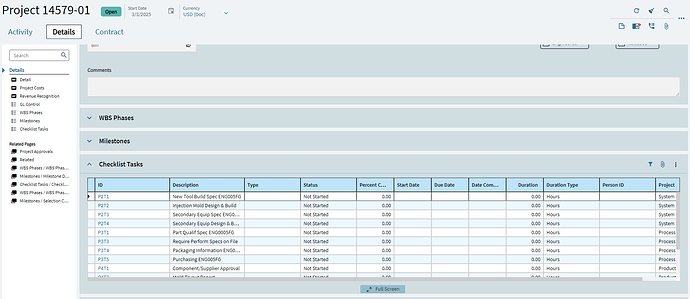

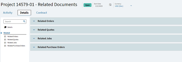

Oh, I would HIGHLY recommend looking deeper into the Project module instead of trying to reimplement it in jobs. (Sorry QA Manager).
A Project tracks ALL quotes, orders, jobs, etc.
AND it has check lists:
And cost tracking and various billing/revenue recognition options.
It may not have all you use today, but it’s a LOT closer to that document above.
