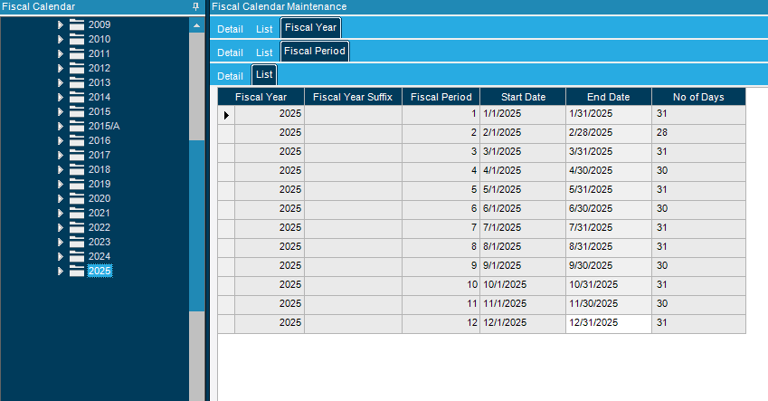

I’m not sure if Fiscal Calendars are cross company. More than likely that company hasn’t had new periods generated for 2025. I’d take a look in Fiscal Calendar Maintenance:
Nope they’re there ![]()
I’d maybe take a look at this. If it’s looking at current period -1 and you’re currently in period 1, it might be that company isn’t handling the year change. If it’s looking for Fiscal Year 2025, Fiscal Period 0, that’s probably missing.
Ok, what does the 2025 Fiscal Year List look like? Does it looks like Kevin’s example with the Start and End dates?
Well only difference was there was no 2026 for the company returning an error I added the 2026 dates and now no error ![]()

2025 looked Just like @kve’s example (just for not ignoring your ?) ![]()
