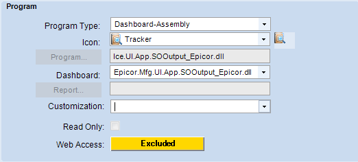

In your menu, re-point your dashboard from the Epicor.Mfg.UI.App to the Ice version of your dashboard.
Hi Aaron, this is what the menu maintenance screen looks like;

In the Dashboard combobox, look for one that says SOOutput_Epicor or something, I bet it’s in there.
I had the same issue when moving from 10 -> 10.1.500 in our test environment, You need to open Dashboard Developer and redeploy the dashboard AND clear the client Cache. Takes a bit of convincing but it should work.
