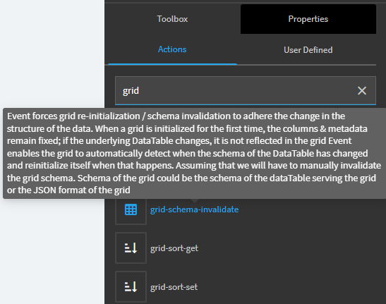

Alternatively, there’s also a grid-schema-invalidate (which I have NEVER played with)… but the tool-tip sounds interesting:
We’re not really changing the grid schema, but I wonder if this would “detect” a change in the datatable values and perhaps reapply the View option?
That may be a complete waste of time… I’ve never used it. So, apologies in advanced if it doesn’t work.
