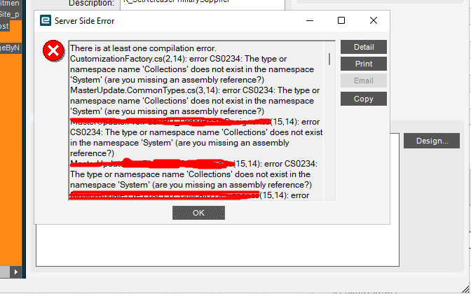

Hi all, I’m unable to make changes to BPMs, functions, or data directives after upgrading to Epicor 11. Everything works fine in another instance, but I’m facing this issue in QA. Any help would be appreciated!

Finally doing my upgrade testing on 2024.2.15 and am getting the same error on all my BPMs. None of them showing as outdated or errorish until you save or verify.
Calling the classic BPM form no errors pop up.
Some BPMs seem to work still, others don’t.
No errors during the upgrade…

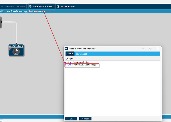

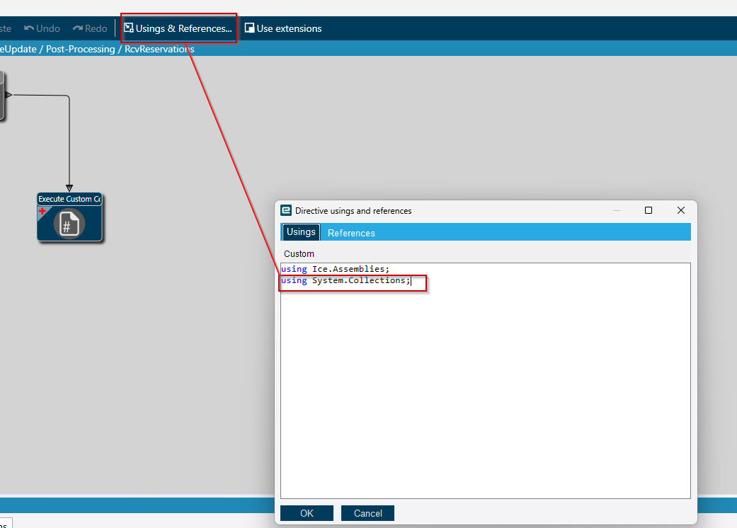

Try this:

The issue occurred because some .NET DLLs were missing during the initial installation. We reinstalled it properly, and that resolved the problem.
I had tried this earlier as well, but unfortunately, it didn’t work. The issue was resolved only after a proper reinstallation, as some .NET DLLs were missing during the initial setup.
