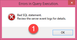

After version Epicor 10.1.500 to 10.2.500 Dashboard “Bad SQL Statement”

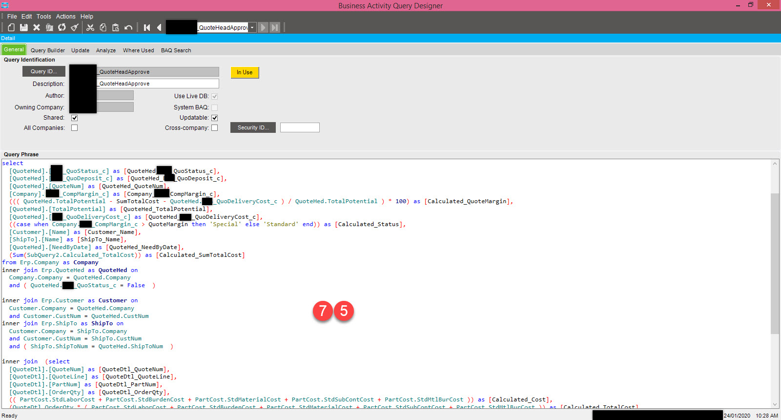

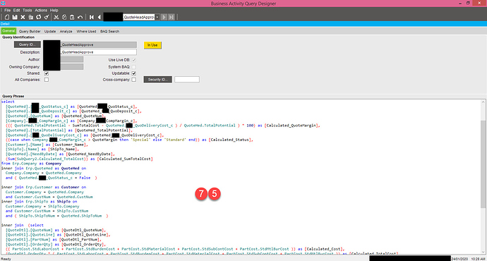

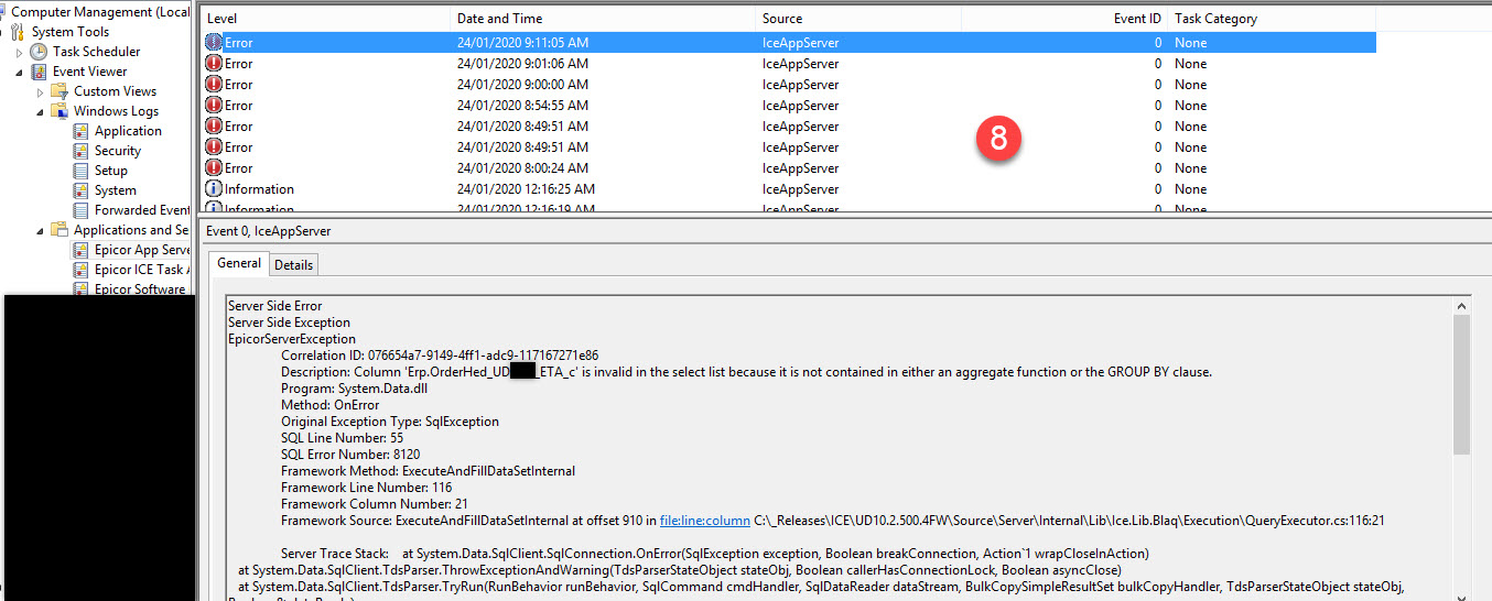

So i have this query Dashboard a problem “Bad SQL Statement” :
2020-01-24_9-25-36

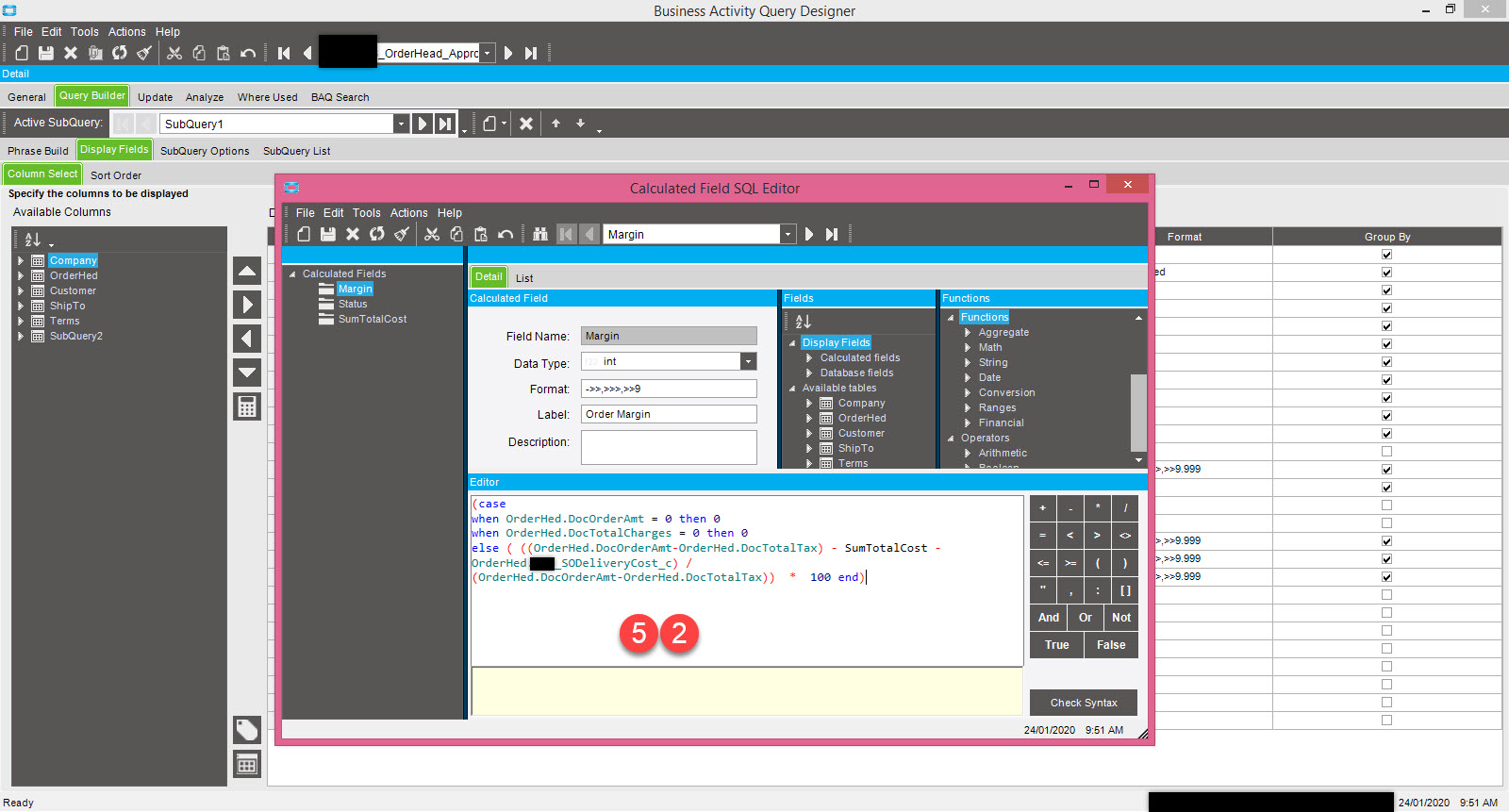

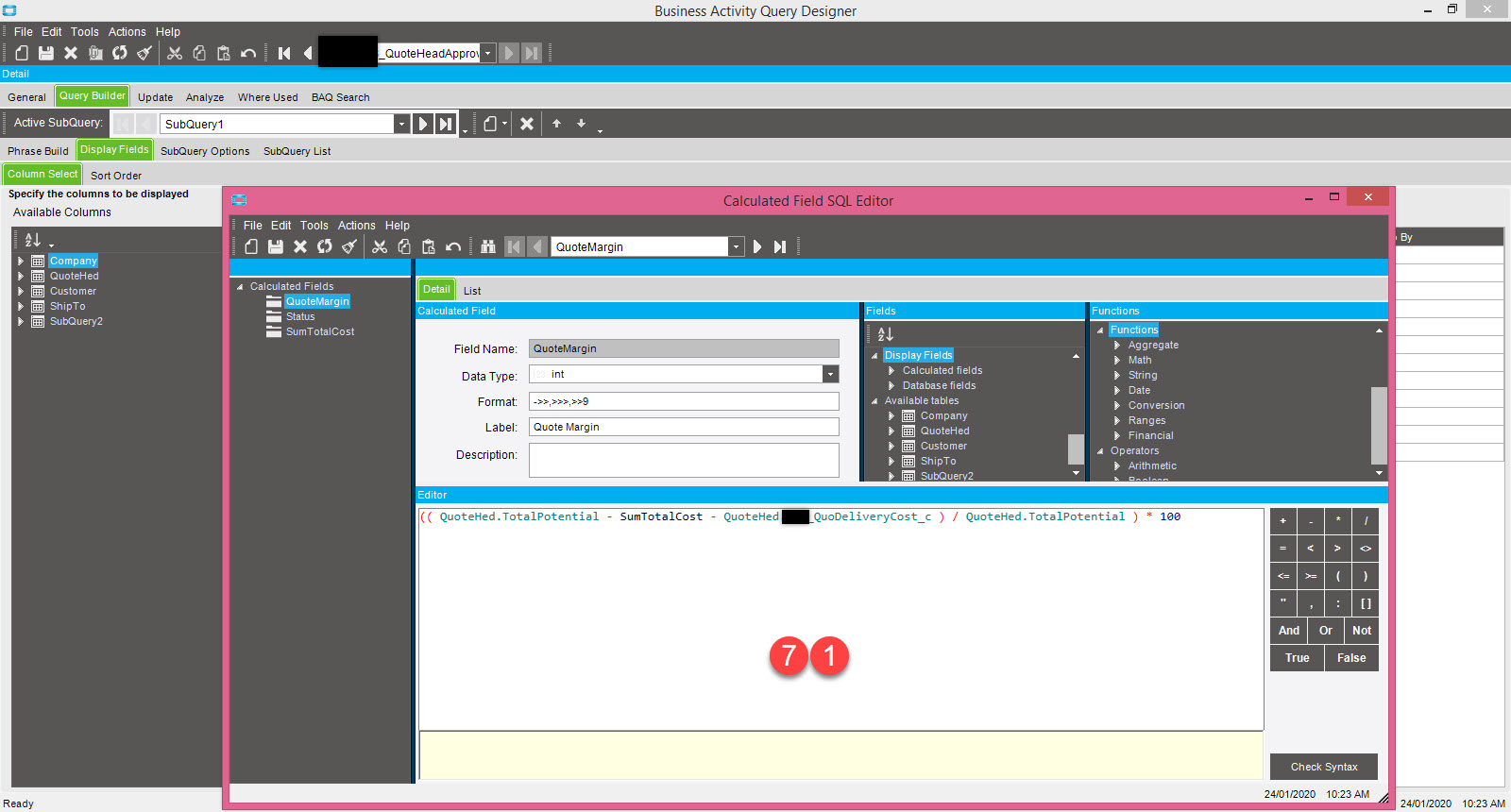

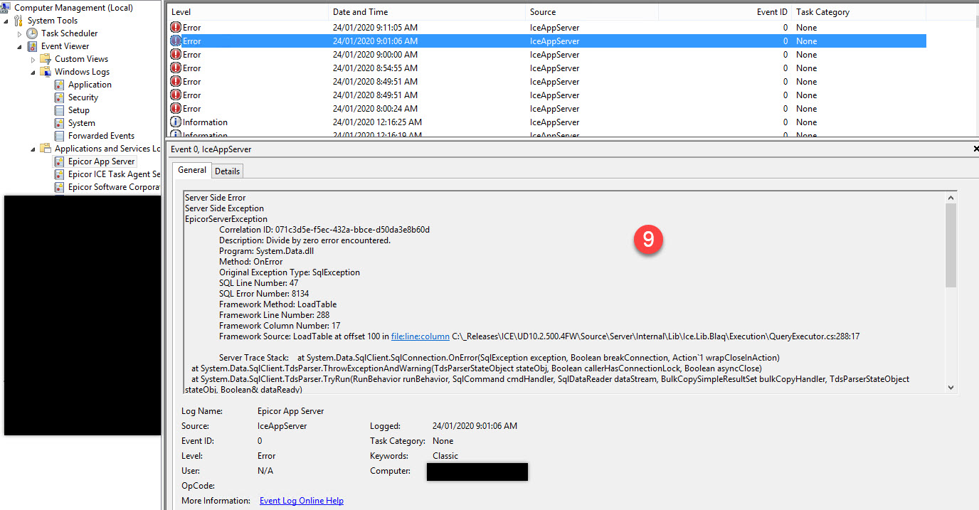

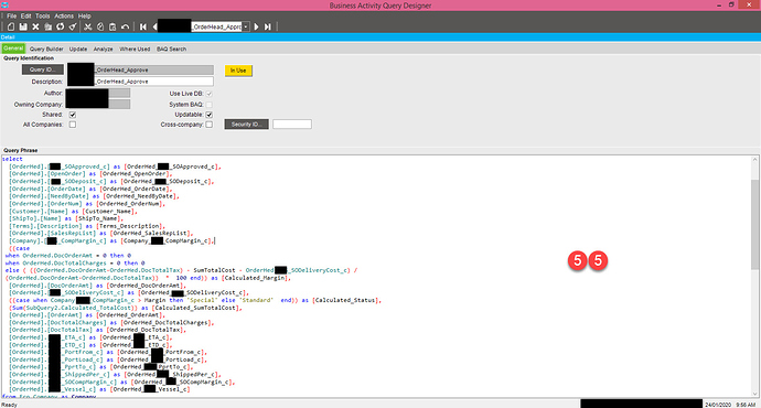

Your error image shows a division by zero… Maybe review your baq ?
How about Quoted.TotalPotential??? can it be zero…
Pierre
@Hogardy I bet my lunch today that you nailed this one.
I will keep that in mind…if it is the case…:wink:
i am open to share though…
Pierre
Thank you. Mr. Hogardy, What kind of code do I need to edit?
