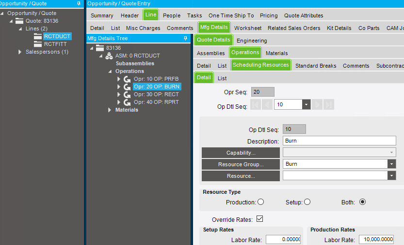

So the code is “technically” working but there is a little snag that I found. The code is updating all the rows in the JobOpDtl as each operation under each line is getting all the values:
Each one of these rows under operations received the 10,000 override rate that I had entered. The catch is that I had RCTDUCT selected in the left pane for the line. If I change the focus to the RCTFITT line, go the summary tab enter in a value for the PreWageRate_c and save it will update only ASM and Operations for the RCTFITT line.
