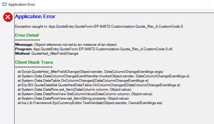

AfterFieldChange code error
Hello
I am trying to add some code that is going to update some values on a quote after a certain case is met. When entering the value in the field I am being met with a “Object reference not set to an instance of an object” Application error.
Here is the code I added:

Do I have to add BO to this case to get it to function how I want?
Try using the above, instead of this
edvQuoteHed.dataView[edvQuoteHed.Row] ["PrevWageRate_c"]
I replaced that line with this:
var prevWageRate = Convert.ToDecimal(args.ProposedValue);
and am still getting the same Application Error:
Try dropping in some message boxes to pop up so you can narrow it down to a specific problem line.
Instead of explicitly trying to access the dataview, use the passed parameter:
args.Row[“YourField”] = xxx
Update - nevermind I see you are also accessing the Dtl view. Make sure you check first that Row >= 0

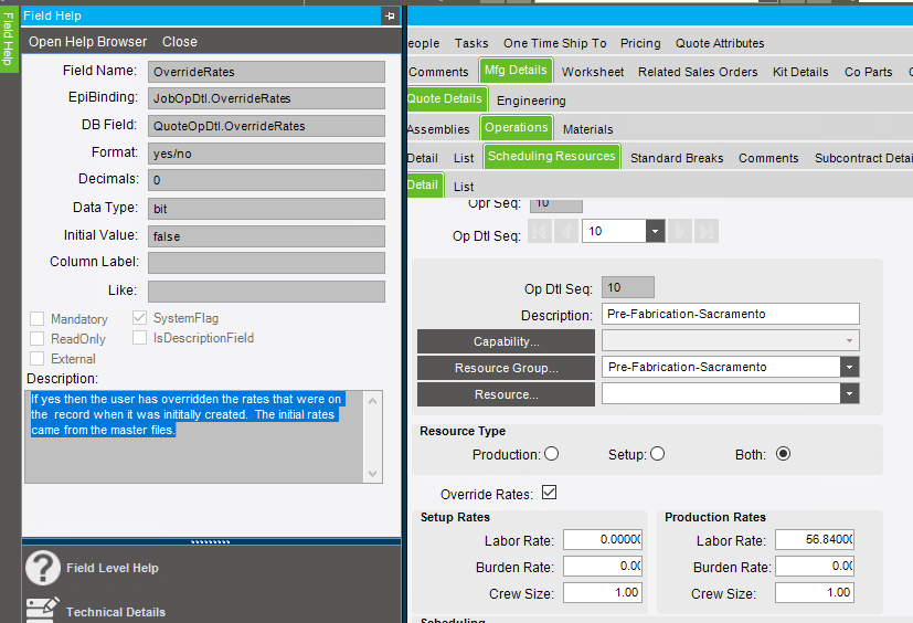

Was looking through field help to make sure that I had the right information and saw that the epibinding and db field are different for the fields I am trying to change:
Ended up combining what @josecgomez and @Chris_Conn suggested and it seems to be working for me right now. Ended up with this for the case statement:

Ended up changing QuoteOpDtl to JobOpDtl along with the change suggested.

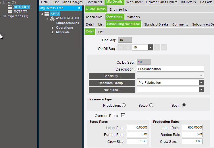

Still a no go. First line has correct values:
Second line does not:
These are the 2 fields I need to change:
At this point I am wondering if it is something with the fields themselves. Or I am going about doing this the wrong way.

I am seeing that ChangeOpDtlOverrideRates method name pop up more than once.
Also the code is acting weird when changing values. I can enter in different values into the PreWageRate box it won’t update the box but will update the lines one at a time so all boxes can have different values.I’ll put a video up of what I am talking about shortly.
Edit:
Just throwing stuff out there as I have no answers or ideas as to why I can’t go through the rows on the dataview on the jobopdtl. Does the fact that the DB field and EpiBinding are different tables have anything to do with it not going through the rows properly?
Does the afterfieldchange event only take the epibinding into account?
