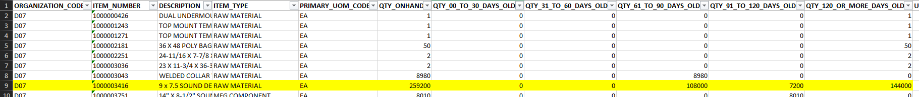

I’m not looking for a last used, but rather the date the part was put into inventory, grouped into 30/60/90/120 day buckets. For instance, in the attached screenshot, the highlighted part has 259,200 on hand. 108,000 of those were put into inventory 61-90 days ago and 7,200 of those were put into inventory 91-120 days ago, and 144,000 where put into inventory over 120 days ago. 108,000 + 7,200 + 144,000 = 259,200 that are currently in stock. Those numbers are from Oracle. Any idea how to replicate this in Epicor?

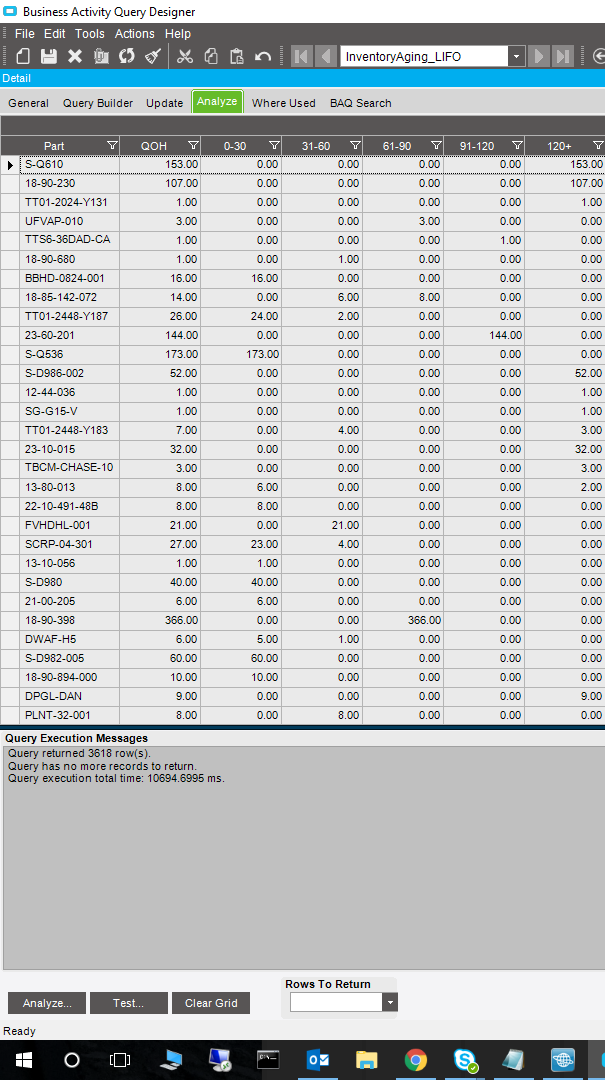

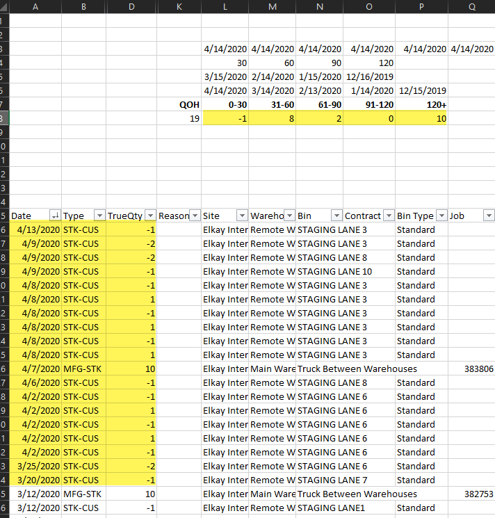

So, it’s close, but not really, lol. The sum of each of the buckets does, indeed, equal the on hand total, but it’s not really showing what bucket each of the 19 pieces is coming from. The problem seems to be when there are more “outs” than “ins” in a bucket. In the screenshot, it is showing “-1 of the 19 on hand” was done in the 0-30 days bucket, which makes sense mathematically because I’m summarizing the “ins” and “outs” in that period, but it’s not quite what they want.
Well, I got something “close enough” to what they were asking. It’s basically Aged Inventory using the LIFO method (Last In First Out) which isn’t what we do in practice, but works for a visualization.
The query works by getting the total on hand (including non-nettable), summarizes the transactions that increase inventory in each date bucket, then subtracts those amounts from the on hand until nothing is left.
Here’s the query if anyone wants it in the future–designed in 10.2.200.11: InventoryAging_LIFO.041520.baq (23.6 KB)
