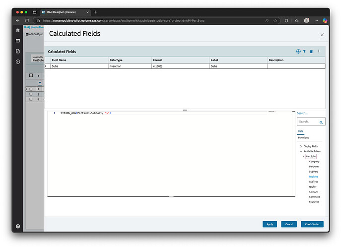

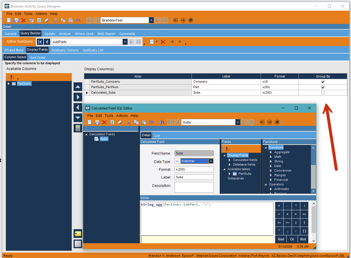

String_agg() works in a calculated field. Even though it’s not in the list, you can type it in.
Can you post more of what you tried so far? What you describe sounds easily do-able, you just have to find the right buttons in BAQ land.

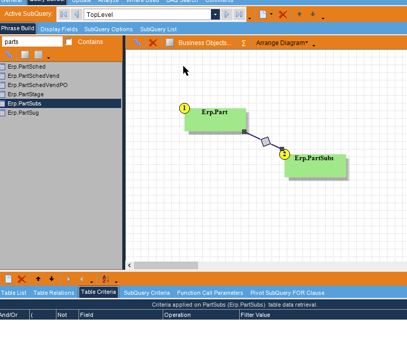

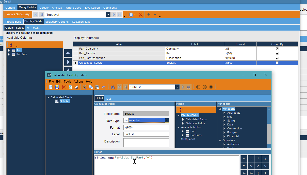

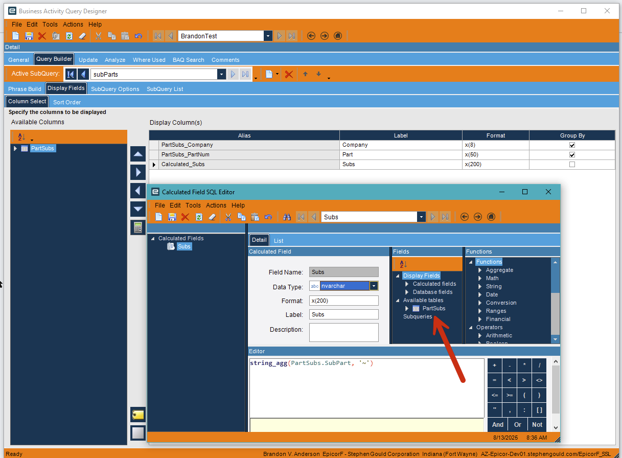

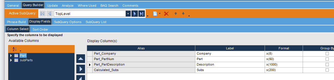

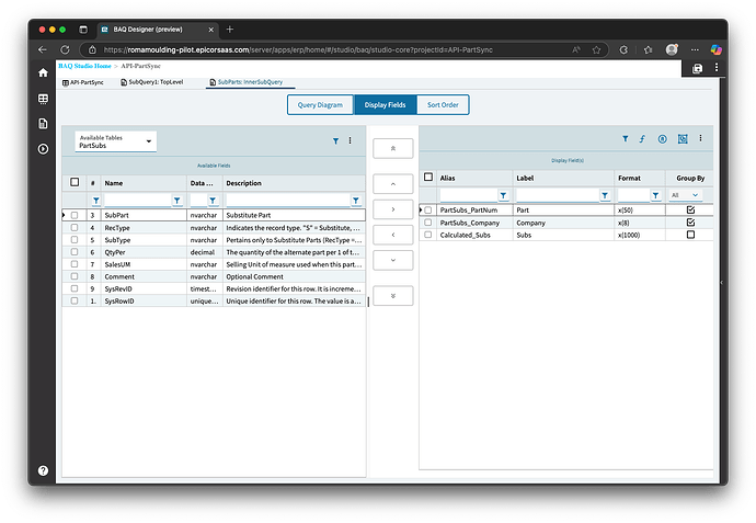

Here’s the subquery and calculated field, don’t forget the “Group By” checkboxes.
Here’s the top level
Results. (We don’t use subs, so we don’t have more than one to list, but this will work)

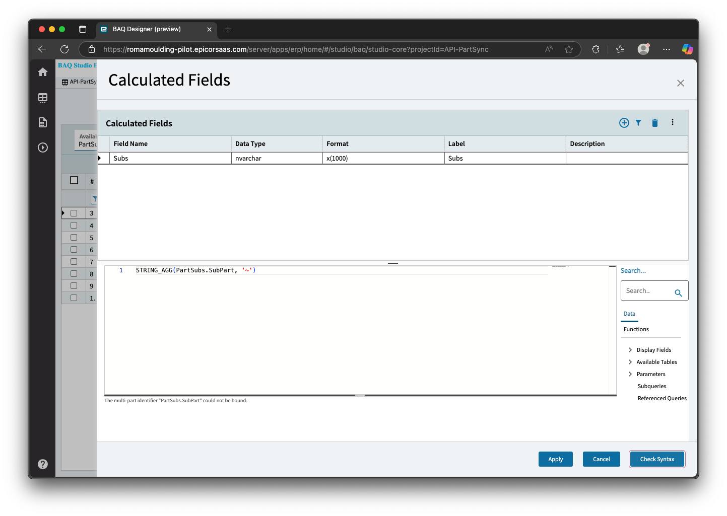

This is so strange. When I check the syntax it reads: The multi-part identifier "PartSubs.SubPart" could not be bound.. Can I trouble you for an export of that query to have a look at how you implemented it? This is boggling my mind.
Ps. it’s so annoying that STRING_AGG isn’t listed!

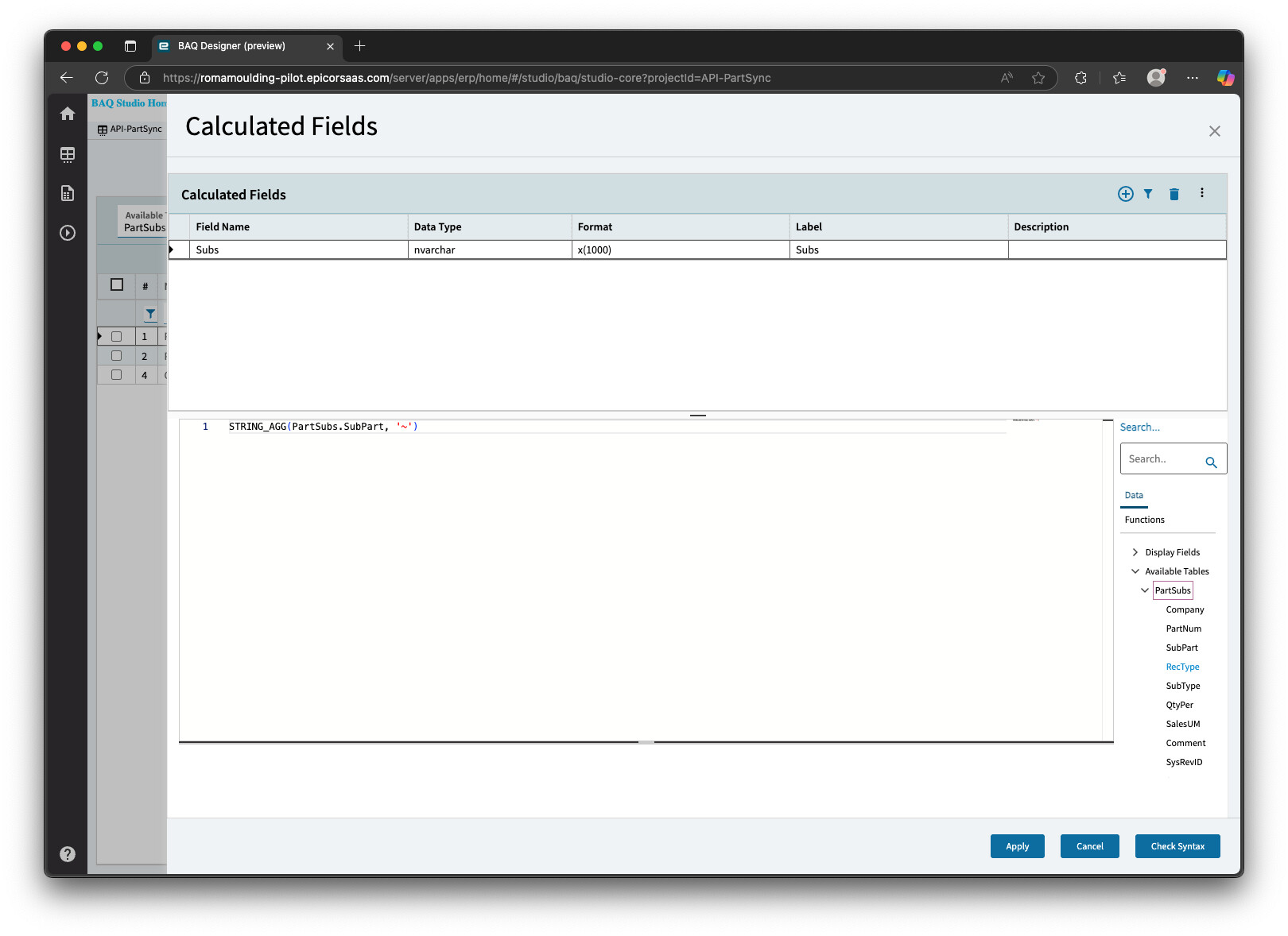

When you add your field to the calculated field, find it in the menu and double click it to add it. Did you add that table more than once? If you did, it might have an alias on it.
Again, show me what you have, and I can probably see what you’re doing wrong.

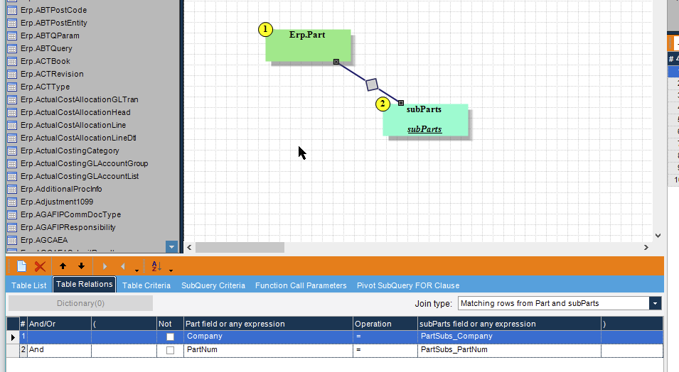

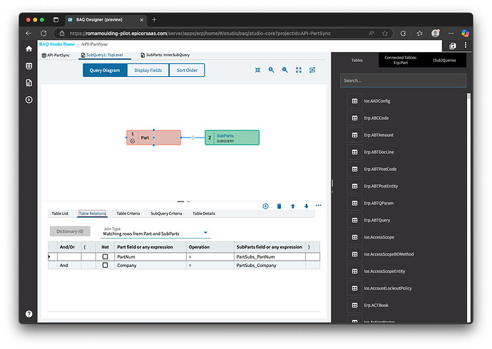

I want to see what this says right here.
Query relationship:

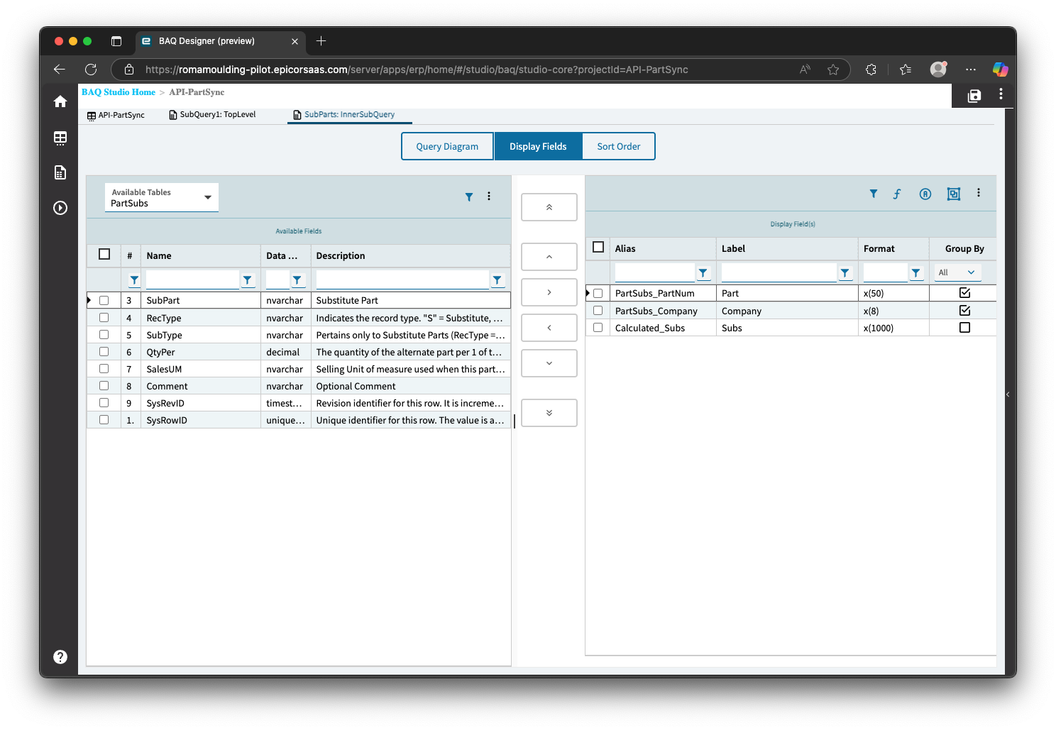

Subquery fields:
Calculated fields:
I’m probably doing something stupidly simple incorrectly lol.

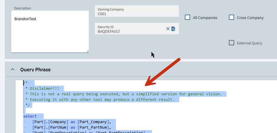

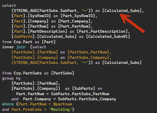

Can you grab the SQL from the query phrase screen too? I don’t see anything wrong in your screen shots.
 * Disclaimer!!!
 * This is not a real query being executed, but a simplified version for general vision.
 * Executing it with any other tool may produce a different result.

 * Disclaimer!!!
select
	(STRING_AGG(PartSubs.SubPart, '~')) as [Calculated_Subs],
	[Part].[SysRowID] as [Part_SysRowID],
	[Part].[Company] as [Part_Company],
	[Part].[PartNum] as [Part_PartNum],
	[Part].[PartDescription] as [Part_PartDescription],
	[SubParts].[Calculated_Subs] as [Calculated_Subs01]
from Erp.Part as [Part]
inner join  (select
	[PartSubs].[PartNum] as [PartSubs_PartNum],
	[PartSubs].[Company] as [PartSubs_Company],
from Erp.PartSubs as [PartSubs]
group by
	[PartSubs].[PartNum],
	[PartSubs].[Company])  as [SubParts] on
	  Part.PartNum = SubParts.PartSubs_PartNum
	and  Part.Company = SubParts.PartSubs_Company
where (Part.PartNum = @partnum
and Part.ProdCode = 'Moulding')
Do you try to create the calculated field in both levels? You just need to bring it in from the subquery like a field. Not re-write it.
Season 3 Wall GIF by The Simpsons
You’re right, I noticed that as you were replying. I must have left that in there accidentally in the original query before trying the subquery.
It’s working now :slight_smile: thanks for catching my stupidity bahaha.
