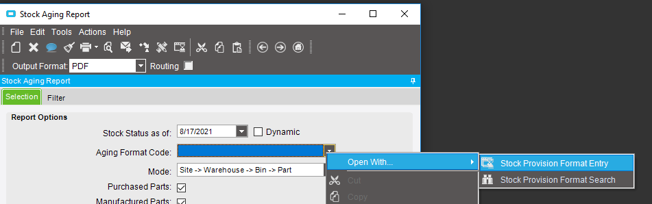

I’ve created several Aging formats codes for the Stock Aging Report, but I can’t see them in the list to select one. I refreshed the list and nothing happens. closed all the windows, even the menu window and even then they don’t appear in the list.
Any thoughts?
What screen did you create the aging codes in? Right click on the dropdown shows an oddly named screen. When I initially looked I went to Aging Report Format, but that is for AR/AP stuff.
