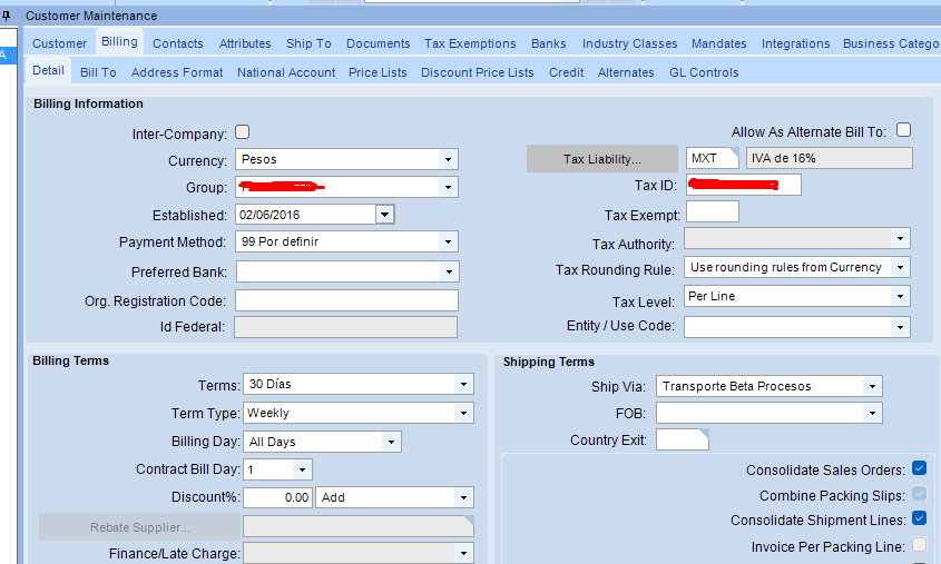

yes i select the packs in the group, the customer is the same, the settings.
You can be a little more specific, because the customer has the same settings in differents sites and i don´t have trouble, just in a specific site. but i don´t know
@jkane we can see in Clara’s picture that she has all the Consolidate Sales Orders, Combine Packing Slips, and Consolidate Shipping lines checked as well as the Billing terms having all days.
I wonder if we are missing something else Clara. Todos los empaques son creados en el mismo periodo fiscal?
Mira este tambien Clarita, dice que Using Get Shipments in AR Invoice Entry – Kinetic 2023.1 (zendesk.com) hay un adjusto en confiugracion de la compania “Use shipment date as invoice Date.” Veo que en tu grupo cambias la fecha a 16/10/2023, pero al principio los empaques teienen la misma fecha de envio?
