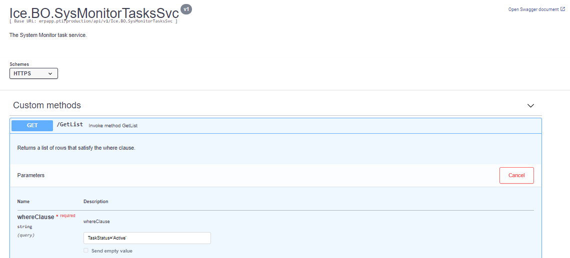

You can also monitor the system with REST calls if you don’t have access to the SQL Server, like some Cloud Users.

The other REST method is using the System Montior Task Service endpoint:
