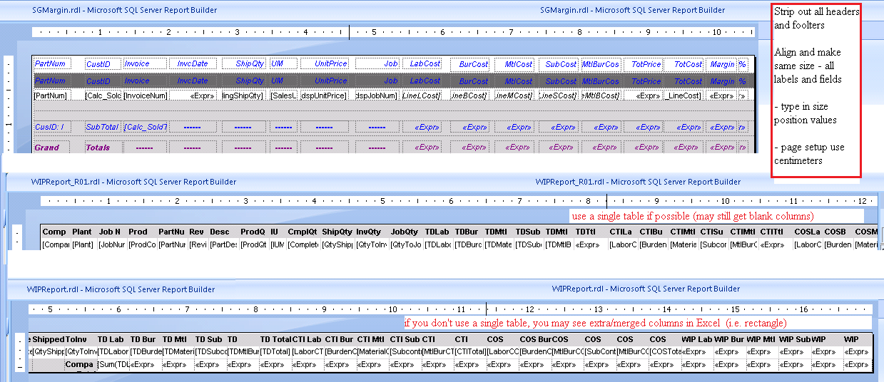

Here’s a screen shot with some approaches I’ve tried… where I have gotten close but there always seems to be something not quite right.

I prefer to put everything into a tablix and have columns for each item. When I make it look like Excel, it exports to Excel very well!
This means that I don’t put textboxes floating around in a rectangle… :slight_smile:
This solves every headache! I will never mess with rectangles and Excel.

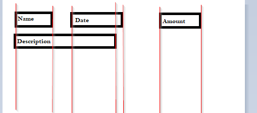

The excel rendering of SSRS is what is making those merged cells.
If I had three fields in the report like:
The excel file would render with 7 columns ( thru G).
  • Column A is from the left edge of the report to the left edge of Name
  • Column B is in line with the field Name
  • Column C is from the right edge of Name to the left edge of Date
  • Column D is in line with the field Date
  • Column E is from the right edge of Date to the left edge of Amount
  • Column F is in line with the field Amount
  • Column G is from the right edge of Amount to the left edge of of the report

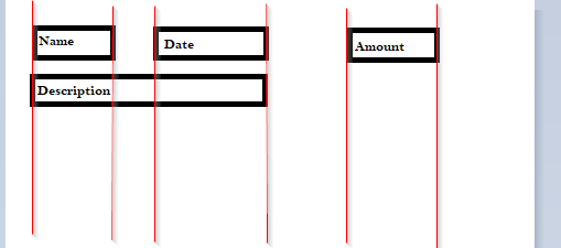

If I add field Description (and it aligns perfectly with Name and Date), I still get 7 columns. With field Description spanning columns B thru D, as merged cells.
If the description field was a little too narrow, like
It would endup making 8 coulmns.
  • Date would now span D thru E
  • Amount would now be in G
  • Description would span B thru D

Its more complex than that. I would use Tablix period, dont waste your time.
But the other factor is if you want Excel to be nice stop using inches, convert everything to metric when I made everything in cm, mm, where its base 10 - I had even more success with rectangles. Then I also removed padding from the boxes. Somehow the math and division the Engine uses, loves base 10.
As for the heading, you will have to align it to consume space as the next 5-6 body boxes or so, or get rid of it, I never found a nice way to get that to work.
Try putting in your heading into a wrapper rectangle
I put headers in my Tablix too. It goes on the outside of all grouping and repeats on new pages.

Not 100% true, but it is too much work for sure. Expand each textbox so that is is the same width and is located with the same “left” property and it often comes out right.
