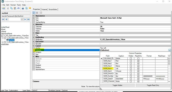

It should be the column name as it is listed in the BAQ. Or you can click on the grid and look at the properties and look at Columns. Use the name there.
Okay it was the field name, so needed the table it was being pulled from as well. It works now!
