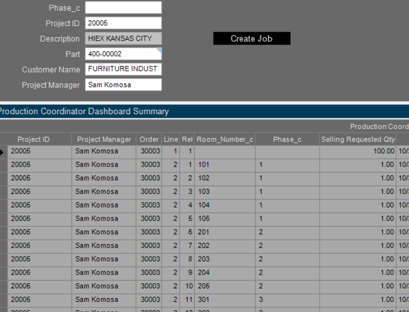

In this dashboard, we want the values in Room_Number_c column of the summary to be center aligned so it doesn’t get confusing with the Rel column values next to it. Is there a way to do this?
@Banderson DynamicQuery Adapter - Grid Format - #4 by Chris_Conn
I saw this post of yours where you pointed to infragistics. Could you tell me where in the dashboard I need to go and add this piece of code to get the alignment to work?

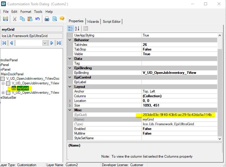

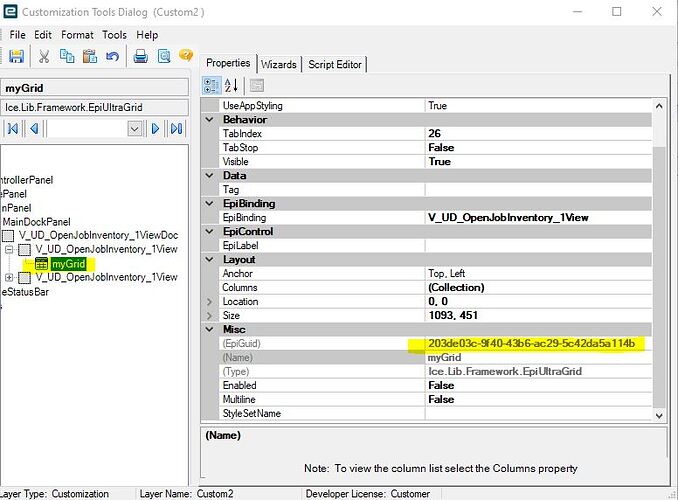

Note: The name of this function should be changed to match your epiview. You can find it by clicking on your grid in customize mode and looking at the properties > EpiBinding. In my case, for the code above the EpiBinding was “V_UD_OpenJobInventory_1View”. Just replace that part with the name of your view.

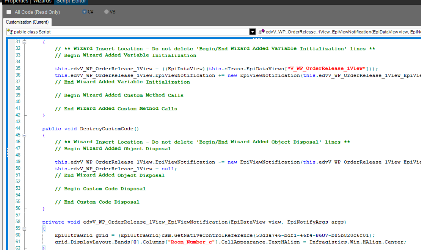

Where below should the line of code for alignment be added? When I add the view, this is what it looks like:
private void edvV_WP_OrderRelease_1View_EpiViewNotification(EpiDataView view, EpiNotifyArgs args)

Where do I find the guid?

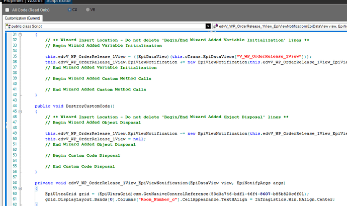

Adding all of that did not change the alignment of the column
Sorry. That all should do it. It works on my end. If you want more help, you are going to have to share some of what it looks like on your end, a la the screenshots that I have shared.
Should adding that view update the rest of the methods as well with it? Or do I need to delete the lines in destroycustomcode, initializecustomcode?
This all looks good. Just put your GUID in double quotes.
Fixed that, still no change
Does the column name need to be the field name or the description?
Do you get any compile errors? Press F5 in your code screen to see.
