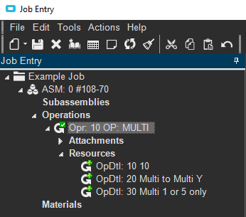

Currently from a scheduling perspective I’d like to implement more capabilities within our ERP. We have a lot of similar machines with subtle differences that allow some parts to run across a few and not others. Part A might be able to run on machines 1,2 and 5 while part B can only run on 2,3, and 5. We’ve used capabilities in the past effectively to help the system route these jobs to the correct resources including preference when needed.
The issue I’m having is whenever scheduling, estimating, or engineering is adding this resource to a MOM it is pulling ALL capabilities. This requires manually removing them and when this step is forgotten we have a job routed to 3+ machines simultaneously.
Is there any way to prevent this from happening by default?

So if you add an operation to a job manually rather than editing the MOM, and that operation is tied to a resource that has capabilities they don’t all end up as scheduled resources? (see pictures)
