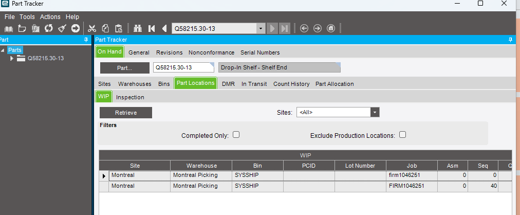

Jose. Quick question about this old topic. What happen with Job numbers. If an user decided to create a job by typing it in lower case, but previously it was another user who created same JOB number buy in capitals, then we will end up having 2 different job numbers and with 2 dif consuming material. How can I fix this?
In theory that should not ever happen unless your SQL instance was modified to care about case. We have specifically set the SQL Indexes to be case agnostic so that even if the part LOOKS lower case, it should find the upper case version. it may still display it lower, but it will find it as though it is equal.
BUT i have heard about customers who tweaked this flag in SQL and then their indexes DID care about case.
Note that we did this to maintain legacy support for our customers who migrated from old versions of Kinetic that were using a “Progress” Database… progress was agnostic to case also… so, Kinetic continues to work the same.
