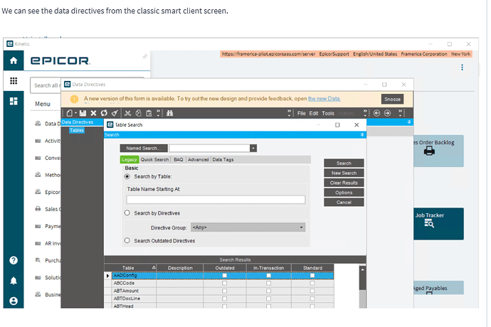

I got this response from support:
A screenshot showing exactly 0 directives, telling me they can see the directives.
Panic is setting in, as our go live date is approaching, so it may be causing me to overreact a bit here, but this seems like a huge problem and this person is pissing down my back and telling me its raining.

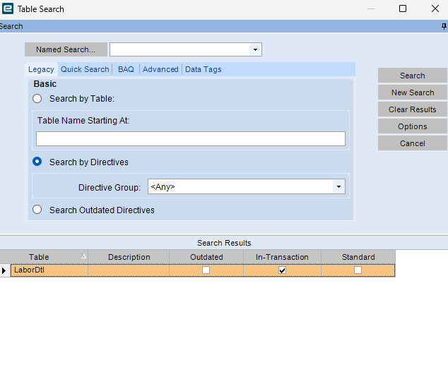

Click the bubble for search by directives. Then click Search.
This is in Data Directives.
I am showing this because this returns one result. This is a BPM I created with support yesterday afternoon when they were helping me uplift something. The support person I was working with mentioned they weren’t at all familiar with this issue, and even consulted with a colleague or two while we were on the call. He even did some light troubleshooting with me like checking my user account permissions to make sure it wasn’t a security/access thing. He found it odd that they were missing and that I was able to create a new BPM.
