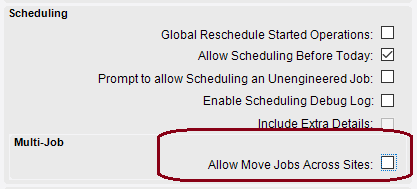

Allow Move Jobs Across Sites:
Anyone know what this bad boy does? Field help is not available “yet”…
This is in Company Configuration → Modules → Production → Job
When I reached out to support on that, it did not do what we wanted it to. WIP doesn’t transfer on a transfer order. It seemed like the functionality wasn’t built out.
Found this in Epicare:
In the Multi-Job pane, note the setting of the Allow Move Jobs Across Sites check box.
Select this check box if you want to enable to functionality to move jobs across sites within the company.
This option is associated with the Schedule Multi-Jobs function, which makes it possible to schedule and re-arrange manufacturing jobs for a parent assembly and its child subassemblies (called predecessor and
successor) all at the same time.
When you select Allow Move Jobs Across Sites and you are running in Multi-Job mode, if you are working with a group of jobs that includes a job in another site, the scheduling engine will treat that job as part of
the group and any rescheduling efforts will also reschedule the job in the other site. This works for any site; it is not limited to the site where the user is logged on.
The Scheduling Board shows jobs in other sites when they are linked to a job in the current site. The jobs from the other sites are read-only, but you can move them as a group by selecting and moving a linked job from the current site.
Note For example, a project to build a school includes several jobs (300, 310, and 320) to be completed on Site A, and one job (400) to be completed on Site B. When you are logged in to Site A, the Scheduling Board will show all four jobs. You can see job 400, but it can only be moved if you move 300, 310, or 320. To move job 400 directly, you must log in to Site B.
If you do not select Allow Move Jobs Across Sites and you are working with jobs that are linked via multi-job, any job that is not in the same site for which you are scheduling is considered a constraint and cannot be moved. The job in the other site will behave as if it were a locked job.
