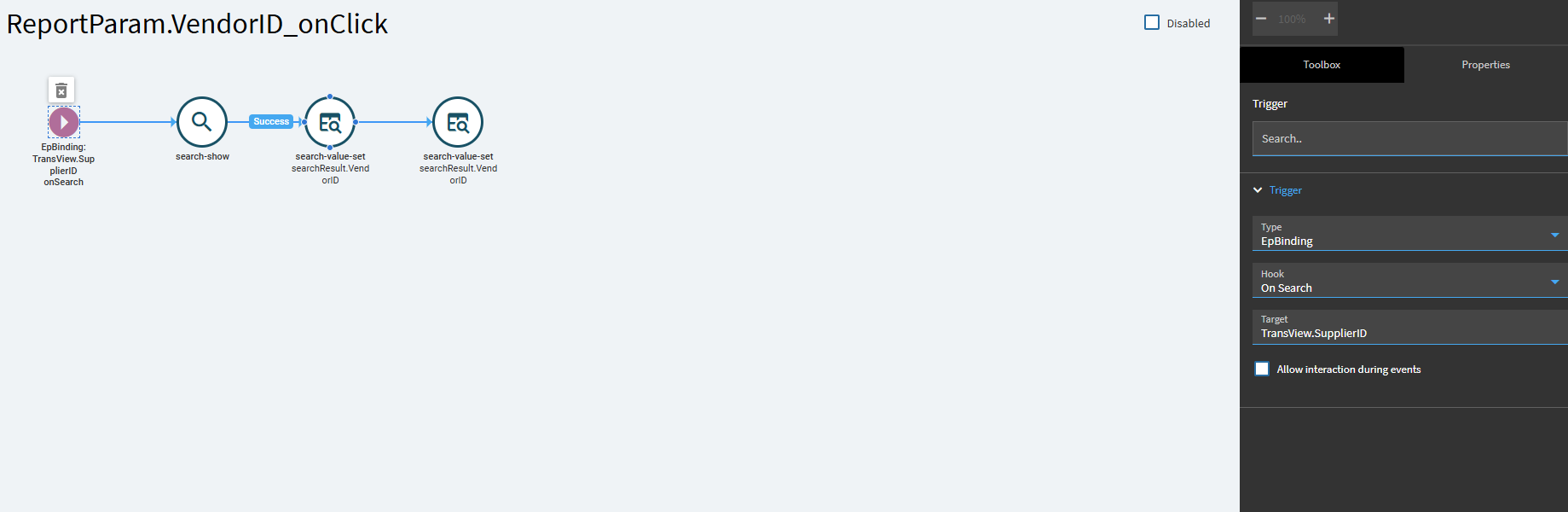

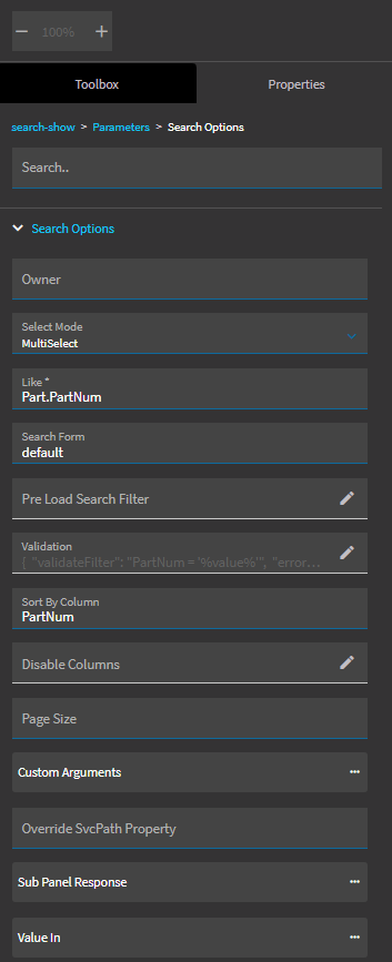

Sure, here is a screenshot of my search-show settings in my on click event.
To make manual entry work, I had to enter this json into the “Validation” property.
	"validateFilter": "PartNum = '%value%'",
	"errorMessage": "Invalid Part Number"
In terms of my search-chip-selection element itself, the only properties I set are the id, EpBinding to my data view, and the Empty Label Text.

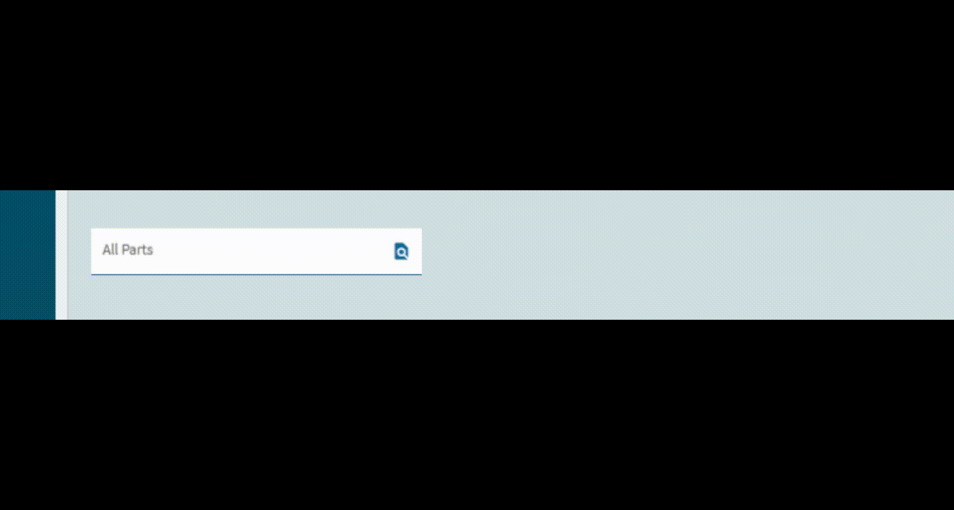

When I enter a value into my input it adds a chip like it normally would when selecting them in search.
2024-12-05 14-32-02

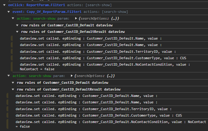

I made a test application to show the debug screen of only the search events happening after manually typing in my value:

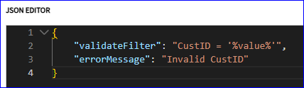

I can’t get mine to work… but I’m trying to do this with a BAQ Report.

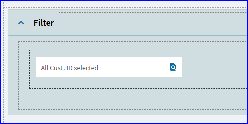

So, the BAQ Report includes a Filter (Customer) in this case. The system created the filter using a Chip:

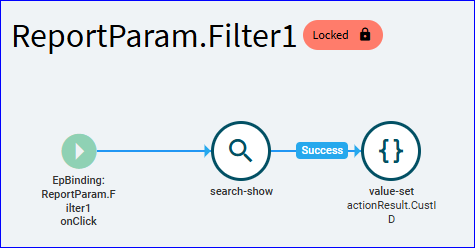

And a base/locked event:

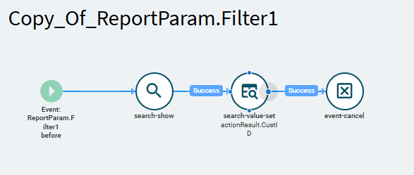

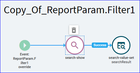

I attempted to create an override event:

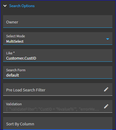

… but I’m still getting the validation error:
I don’t even see an event fire… so I can’t verify that my override is kicking off.
I was able to replicate what you’re experiencing. It looks like the override event isn’t firing at all.
I’m testing this by clicking the search button to open the search slide out. I would assume if my override event was firing it would choose to fire when I click the search button too. When looking in the console with debug on, I only see it firing the base event. This would explain why the validateFilter error is still showing.
I also tried to overcome this issue with the before event hook. While this did fire my custom event, I was unable to stop it from firing the original event with event-cancel.
So far it looks like this functionality may not be able to be implemented on BAQ Report forms.
