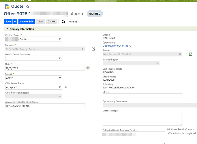

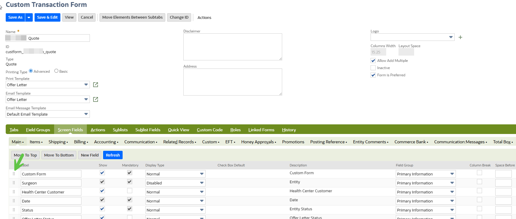

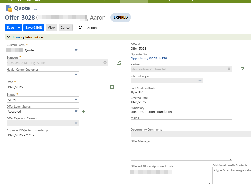

Native UI form customization is really, really straightforward. You add the field to the record type, organize the field into the group, and then it places it on the form. It’s not a drag/drop interface like Epicor, but rather configuration based with a UI to support it. This makes the 99% of UI customization very easy to manage and deploy. The ‘downside’ if you’ll call it that (and I did at first, since I was used to the dense Epicor forms and ability to place fields wherever) is it will fit the fields to the form according to index position (shown by the arrow there) and whether there is a column break or no. There is no weirdness when doing this kind of customization and it’s extremely stable and straightforward.

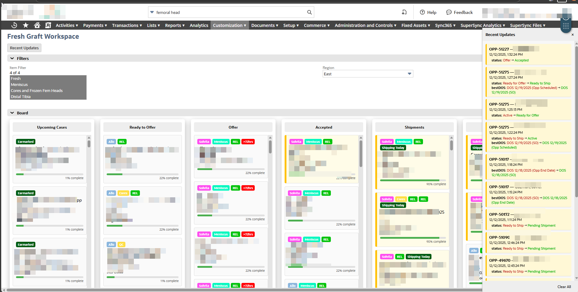

There is also a whole suite (no pun intended) of developer tools to do ‘real’ development. For instance, I built a whole-a$$ Trello-like board recently with real-time updates utilizing something called a Suitelet, which is completely server-side code to in this case render a form, a ‘client script’ which is a different type of script loaded into the browser (which handles all the custom HTML/CSS/JS work), and a script type called ‘restlets’ to perform REST calls from the browser to the server to execute custom code (i.e. load incremental data, update data, etc.).
So, you’re really not limited by a tool set, particularly if you want those heavily customized UIs like you do.
