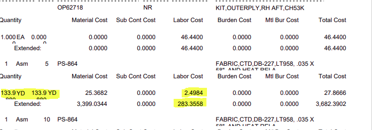

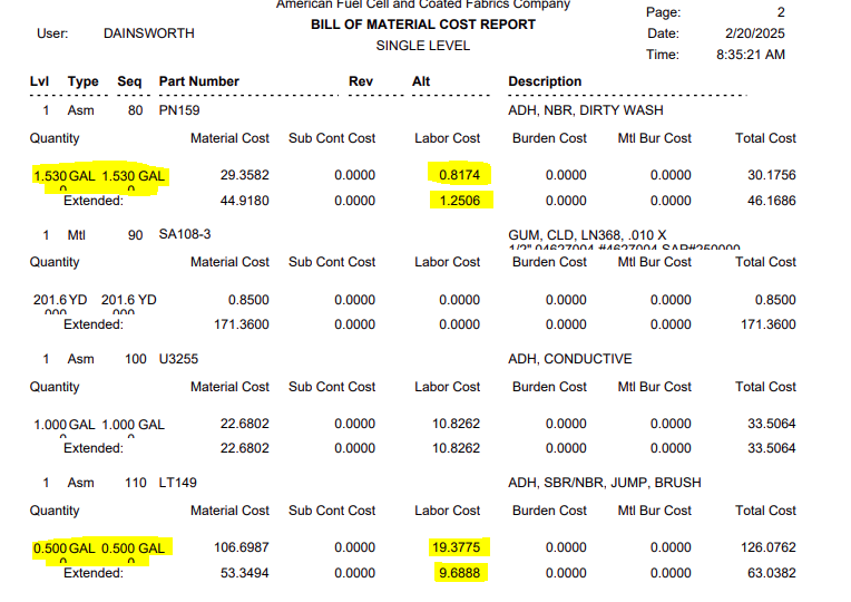

Each report is being ran for a part with only one approved revision on a “Single-Level” parameter. Notice under this image where the unit cost (0.8174) multiplied by the quantity (1.5300 GAL) equals the extended cost (1.2506). This behavior is replicated further in the highlighted fields further down.
However in this scenario, the unit labor cost (2.4984) multiplied by the quantity of (133.9990 YDS) equals (283.3558). 2.4984 x 133.9990 = 334.7831. What is causing the extended cost to display such a smaller amount than what should be calculated? The only difference is we have setup hours along with a costing lot size for PS-864 assembly. Any help is greatly appreciated.

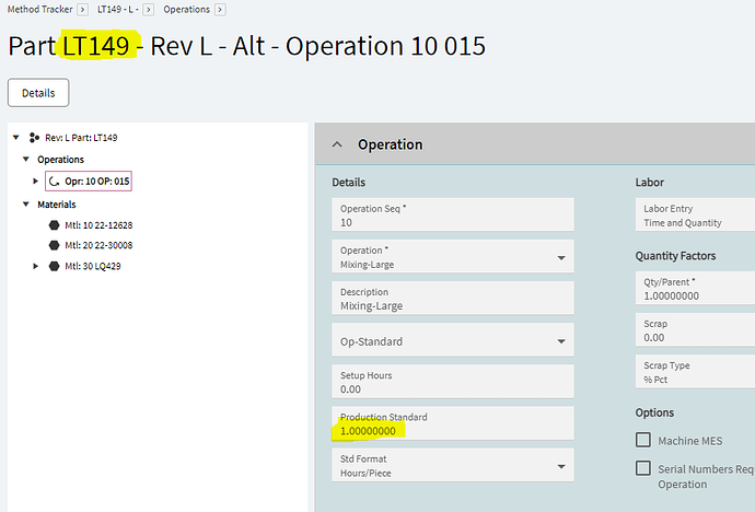

Actually, maybe that’s your issue. Can you confirm that operation has 1 unit/hr or 1 hr/unit as the ProdStandard?

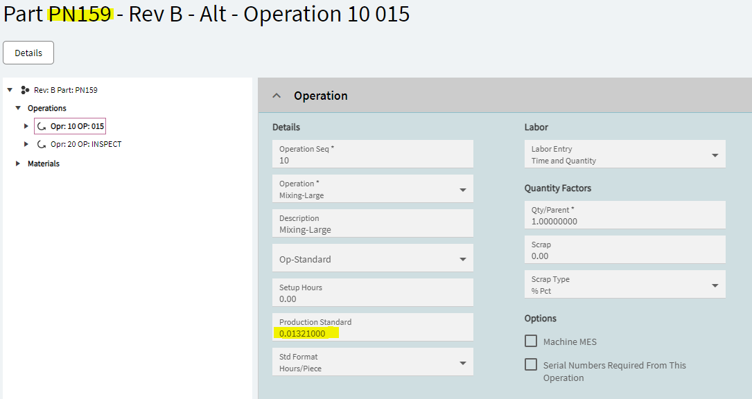

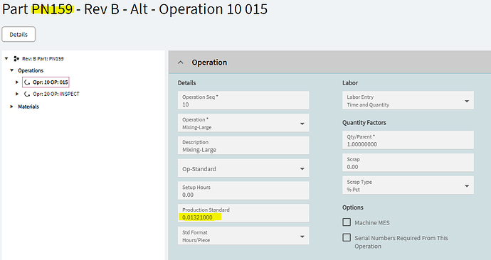

PN159 has prod std <1 hours/unit

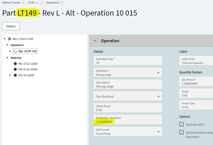

LT149 does have prod std =1 hours/unit

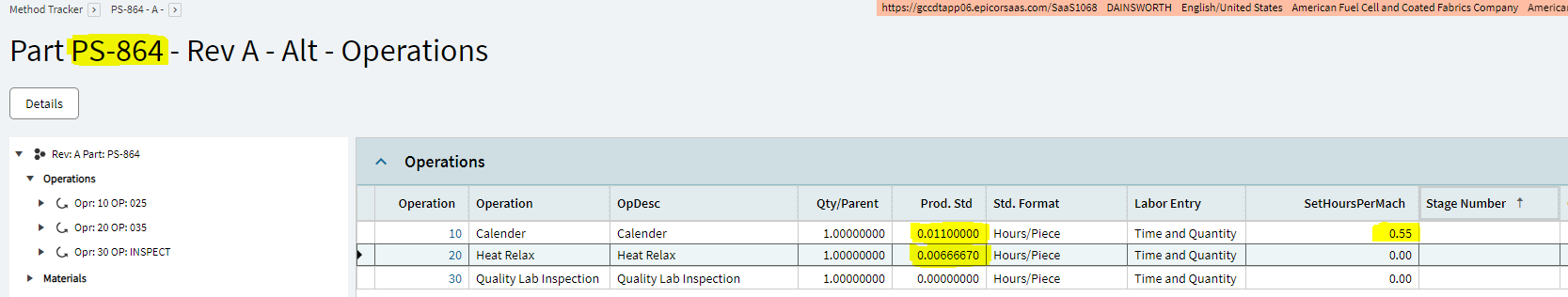

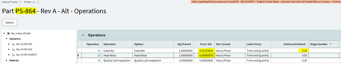

PS-864 (example with different behavior) has 2 operations where standards also are <1 hours/unit, but as you can see does include some setup hours.
I would guess the setup hours make the difference. I’m fairly certain that the per unit labor cost of setup decreases as the quantity of units increases. Not positive about that, you may want to do some testing.

That makes me think it’s got to be the Setup Hours. Since setup hours are not multiplied by quantity as ProdStandard / Production hours are, the per unit labor cost of 1 unit will be higher than the per unit labor cost of 133.9 units. I’m guessing that’s what happened here. Can’t be sure without testing or playing with it.
Setup hours and whatever you have for costing lot size right? Or does that not come into this report?
It does come in for calculating the labor cost for the part, but I didn’t think would have anything to do with the extended cost. But I am going to do some digging and see if I can figure out the math behind it.
Any fixed costs (like setup) are going to be spread across (divided) by your costing lot size, to come up with your per unit labor fixed cost.
