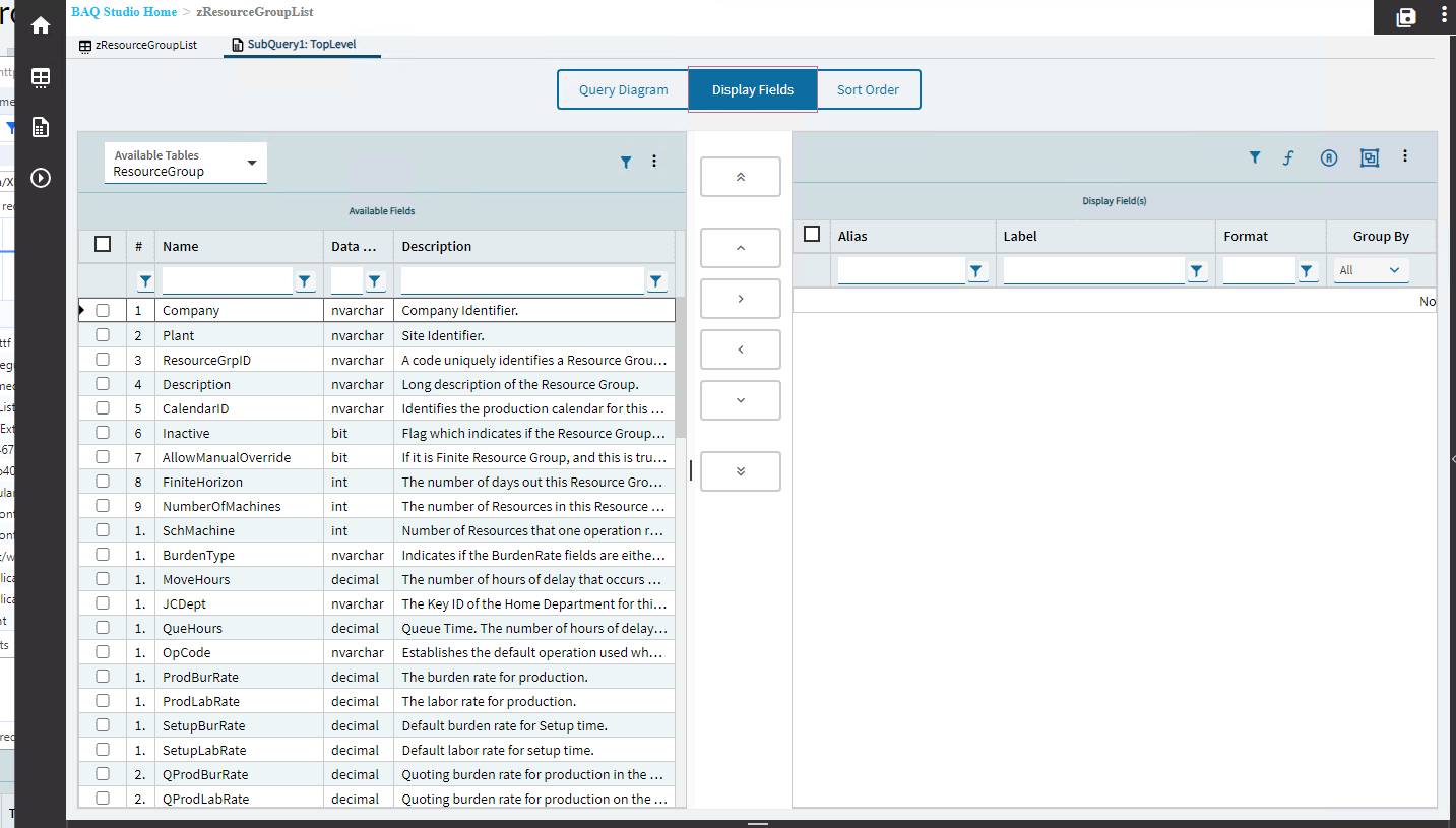

As you can see this uses the zResourceGroupList out of the box BAQ. When I open that BAQ up in BAQ designer (Kinetic version) it has zero columns on the display side.
Would that cause this error? I’m just confused about the ambiguous column error.
that is weird. I’d make a copy of the BAQ and add the key fields and the Description columns to the BAQ then change the dashboard to use the new BAQ.
