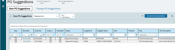

This is what I observe in Requisition Entry.
  • Requisition was created by Zeke in site A
  • Final approval (send to purchasing) from Janice in site B
  • PO suggestion(s) is/are created in… site B?
  • “Buy” the suggestion(s); the releases are created in… site B also?
So the site on the (eventual) PO release stems from the dispatcher, not anything on the requisition itself?
Awesome Avalanche GIF
Again, I’d love to be wrong.
There is no “Plant” field in either the ReqHead, ReqDtl or ReqActs tables. I’ve never had to check this before, but it would appear that the only place for a plant to appear would be at the Purchasing side.
Well that would be a pretty good sign…
For the general populace: apparently the suggestions screen has a site field. For several reasons, I never noticed that before. But as you might expect, it carries through to the PO once created.
